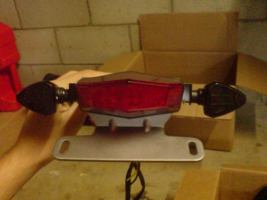

This is it, i bought it in red, i also bought turn signals in smoke.

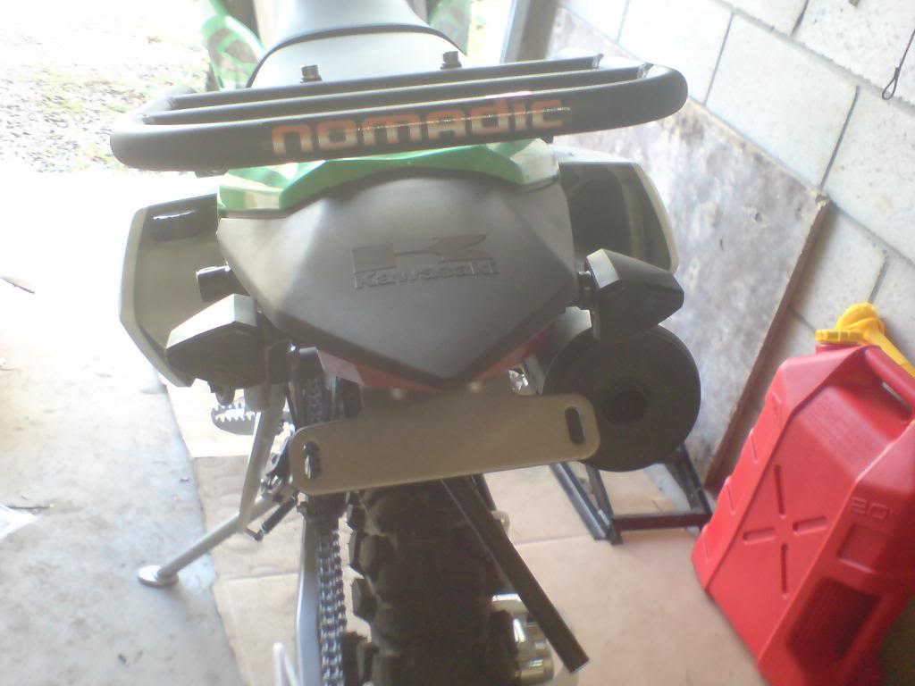

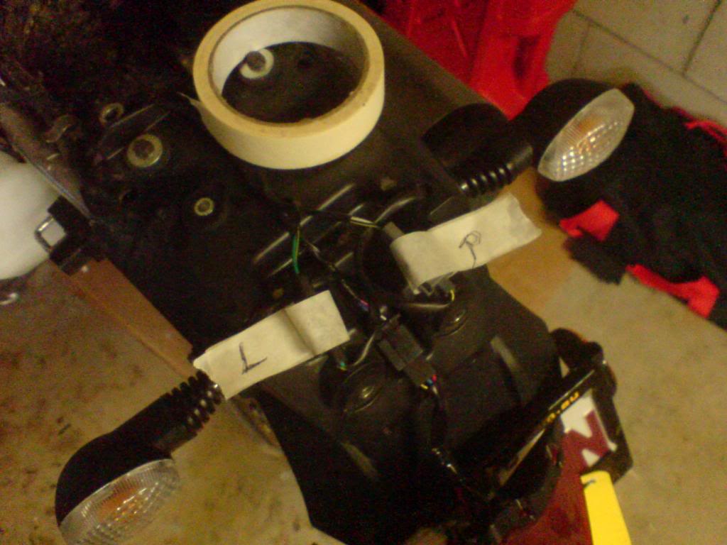

I made sure to mark left and right on the cables.

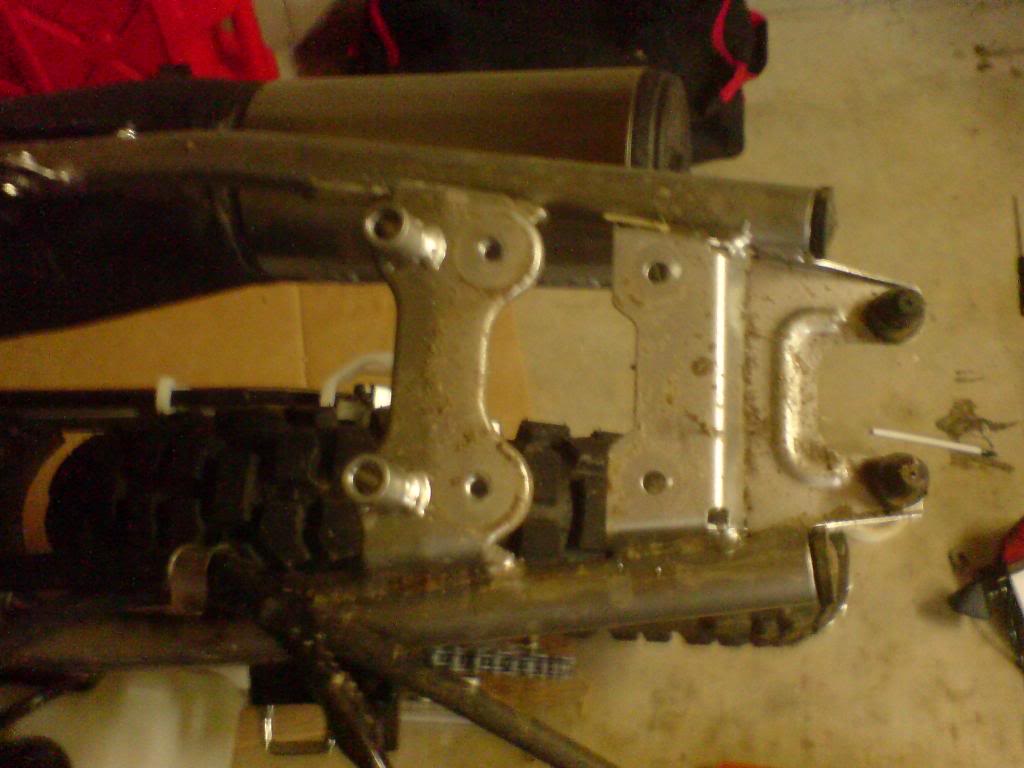

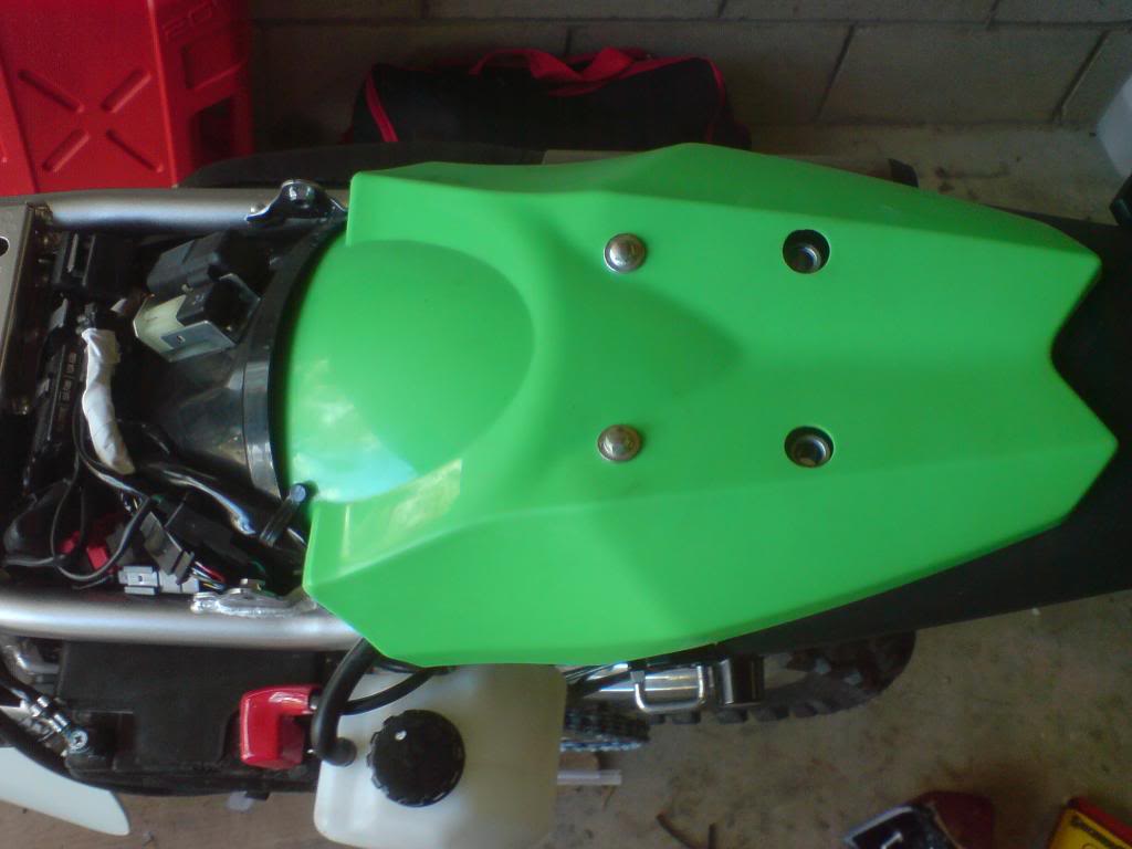

I took off the rear fender and all the black plastic, and while i had it off i gave it a bit of a clean. HOW DOES DIRT GET EVERYWHERE!

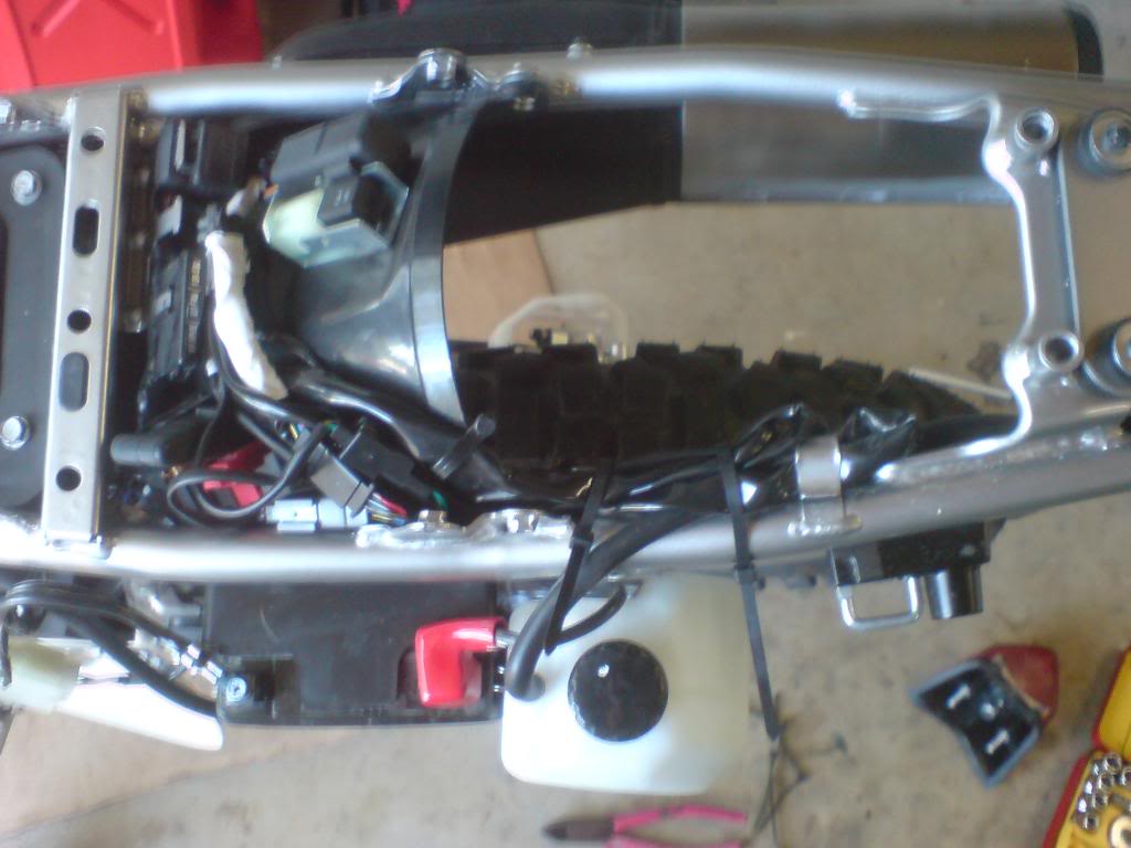

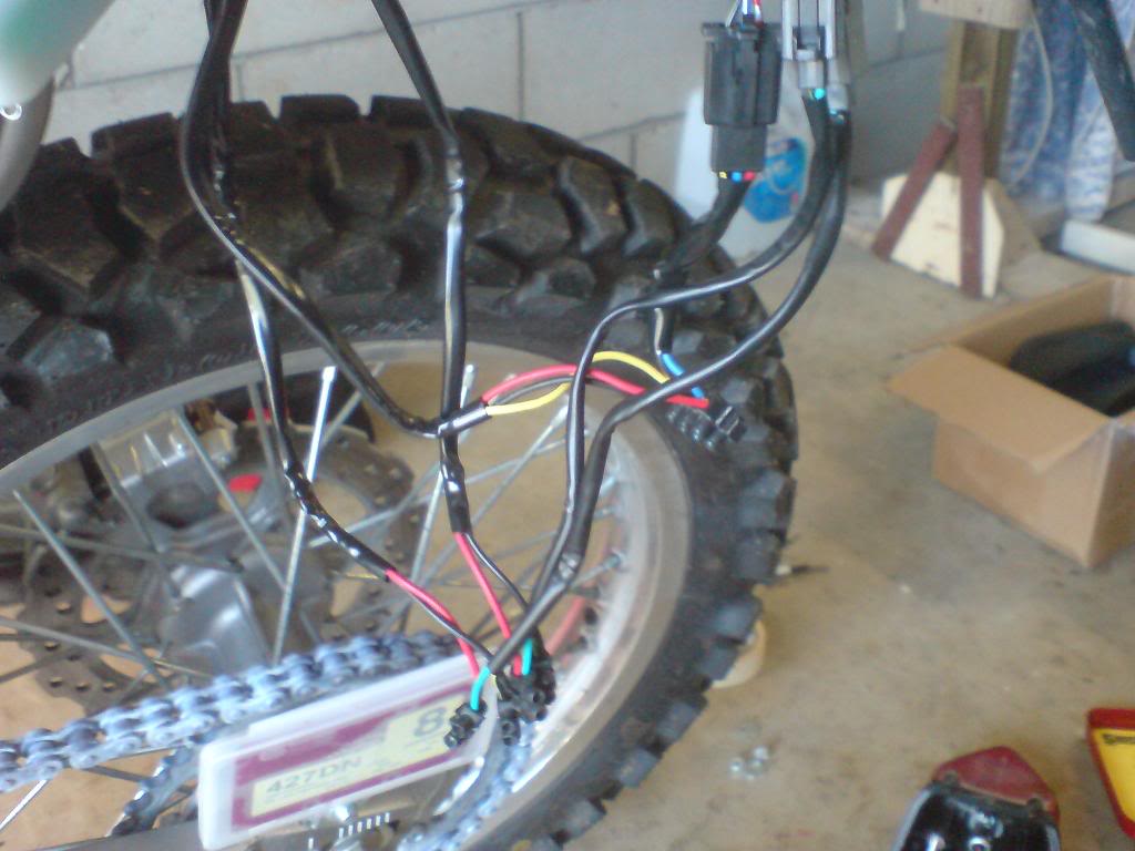

I started wiring, i left a lot of length, is this a bad thing? Instead of using the provided cable clips. I just used block terminals because i couldn't be bothered going out to buy the crimping tool.

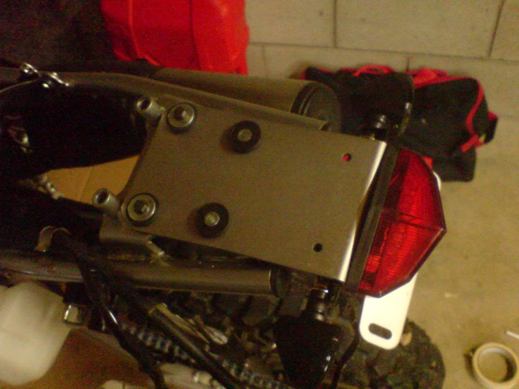

I neatened up the cables with a few cable ties, and put all the terminal connections under the seat.

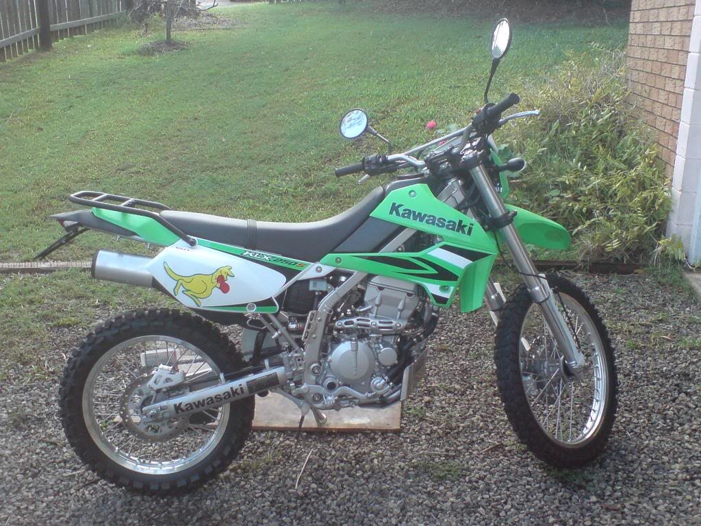

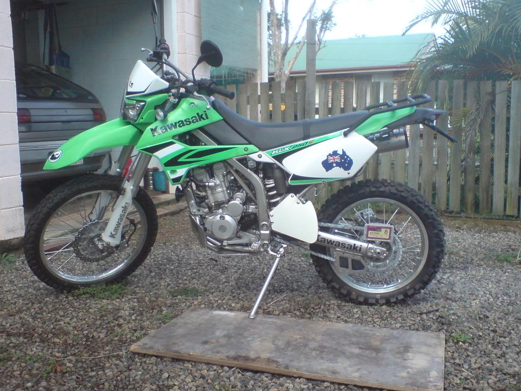

This is my first ever bike and it's the biggest mod i have ever done, so if a noob like me can do it im sure u can too
