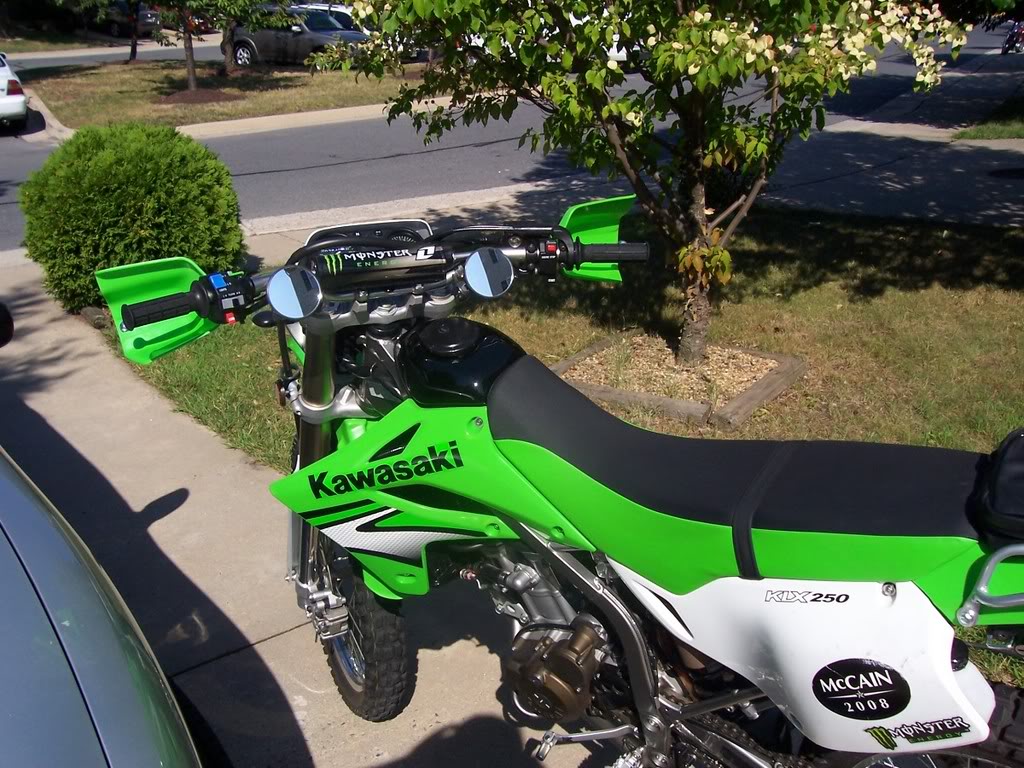

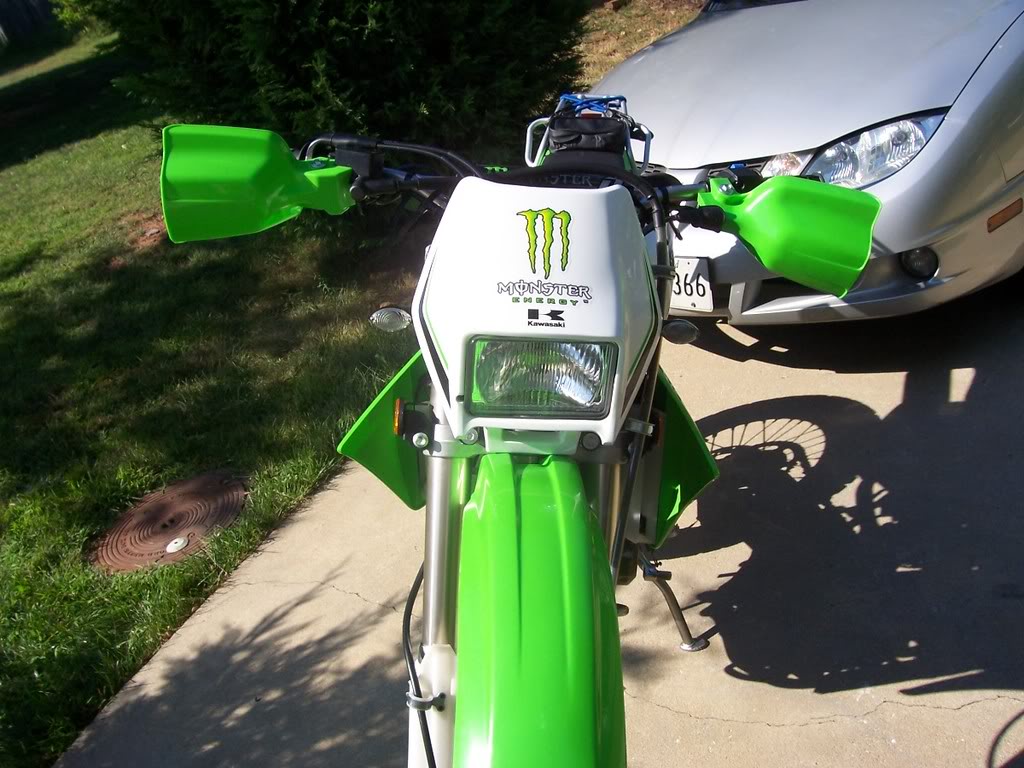

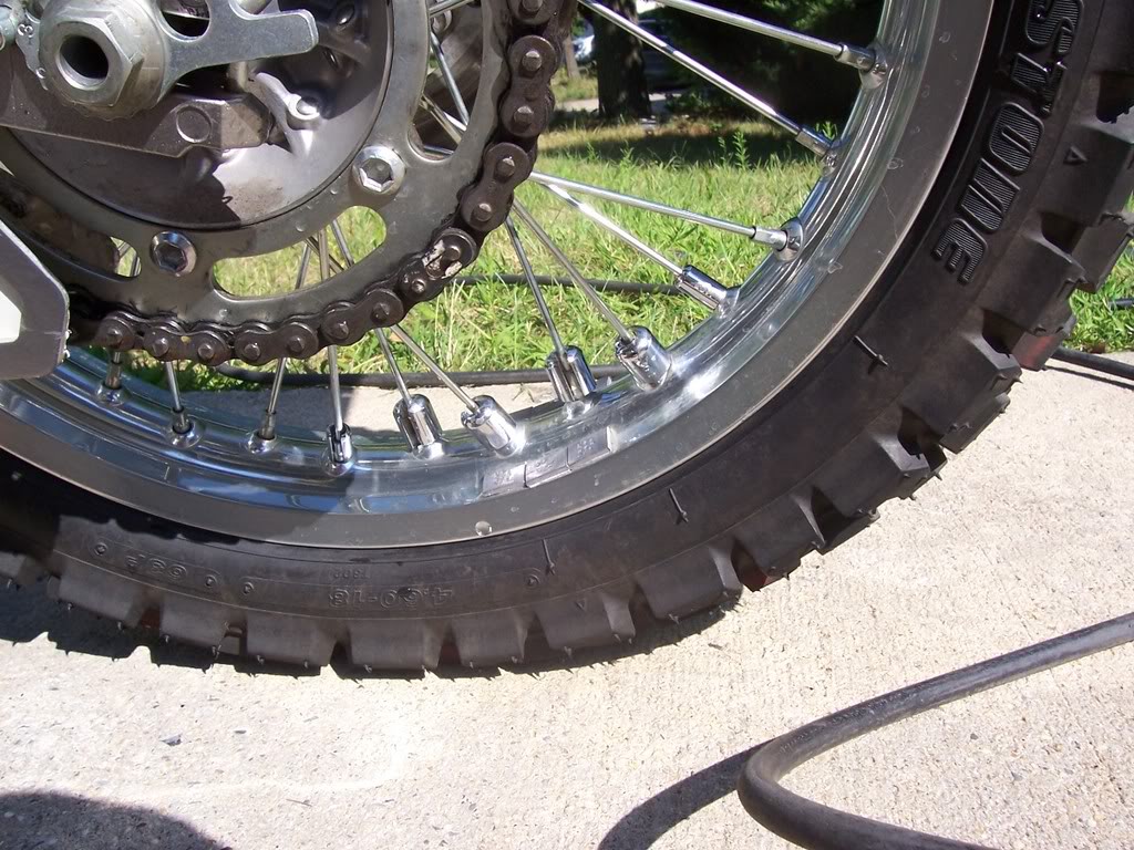

Finally got some of the first mods out of the way on my '07. Mirrors, bilnkers, and ballanced rim lock. I finally got a hold of Dual Star and they got me the mirrors I've been coveting for awhile now. Nice people, good product but I about choked when they answered the phone as I'd called so many times to no avail. Here are a few pics. The spoke weights look about as good as they can for spoke weights. I added a Monster bar pad and decals as well. Having a good summer with the bike.

From: Colombo 7, Sri Lanka
Hey, is it possible to fit a bar pad onto the stock handlebar? Mine has a Cable Holder on the middle ..
Old Aug 19, 2008 | 12:27 PM
KDXmike's Avatar
Posts: 844
From: Maryland
The smaller pad fit's the '07 but it's not centered. If your cable holder is in the middle then you'll have to do some modifications to the pad.

From: R.I.
what kind of blinkers and where did you get em , they look good!
Old Aug 19, 2008 | 02:39 PM
KDXmike's Avatar
Posts: 844
From: Maryland
Thanks. The blinkers are made by Bikemaster, I got them at my local shop. They're non-LED so they were an easy install without having to worry about adding a resistor to correct the blink speed.
Mike

From: R.I.
were the supplied wires on the blinkers long enough, and did they just plug in ?
Old Aug 19, 2008 | 04:59 PM
KDXmike's Avatar
Posts: 844
From: Maryland
Yeah, the wires were plenty long enough because I spliced them underneath the back fender I dapped a bit of silicone sealent on the connectors for good measure, wrapped them in electrical tape, tied them up with 'tie-wraps' and tucked them away.

Question
why did u put on spoke weights? Are u running a rim-lock or did u just correct a shake in the wheel/tire? i am curious as i have a shake in the front since i put in a HD tube, but I am not running any rim-locks....I wonder if these weights would fix that or not.
