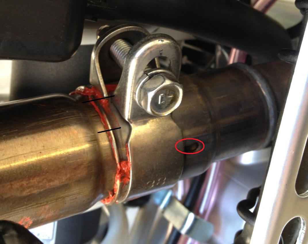

I couldnt find the exact torque for the muffler joint clamp in the service manual. If you really want to get rid of the leak at the joint I would rotate the clamp so that the V notch in the clamp is between one of the four sections created by the four slots in the header pipe (black stripes in pic) and also make sure the sealant is in place at the red oval in pic.
