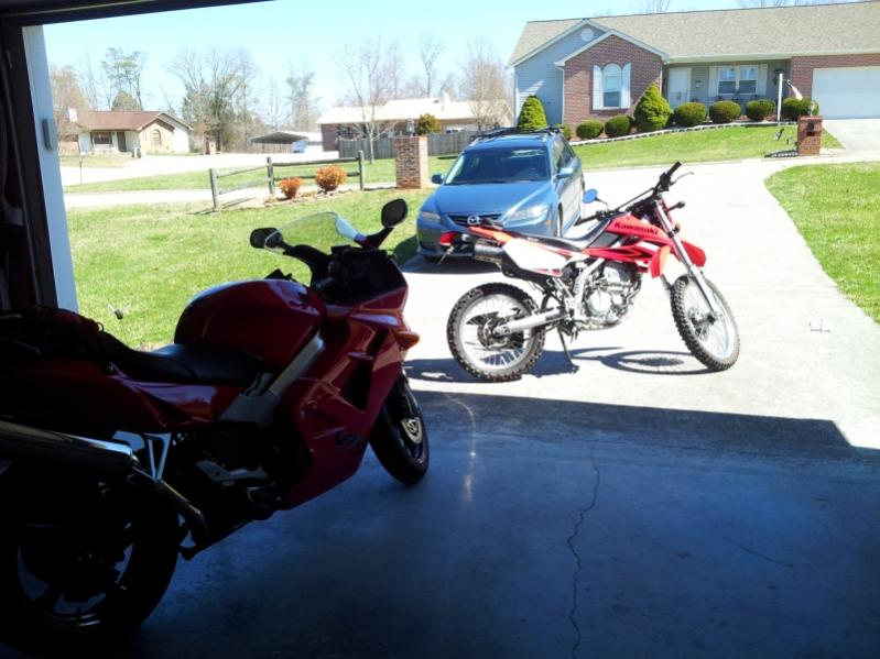

a dual sport mule in the barn (with THE stumble!)
well, at least for a honda guy, its not green !!!
ive been wanting a DS for a couple of years. havent had a dirt bike since i was a kid, but been on street bikes for approx 25 years. d@mn frustrated when the pavement ended, and i left wondering just what was down those gravel and dirt trails. and was never gonna find out on the VFRs.
my criteria was: lightweight, trail capable and street legal, MPG, and mech simple.
a buddy has a drz-4, it just felt heavy to me, and especially up high. i wanted to like the CRF-230/250, but a couple of test rides proved that they just felt too small for me (even though they were RED!)
so... a 09 KLX250-S popped up on CL nearby, and i was 1st to get there.
clean, 3k miles, stock, some xtras, sane owner, ready to ride, and its RED!
the only thing it really needed for my needs was a rear rack,
and of course to decide what tires to run in the near future.
for what i wanted, i think its gonna be nearly perfect. its pure joy down a country road at 40-60 MPH, and i can now explore all those off the pavement excursions i see.
i recently relocated to east-TN, and there is ALOT of off-road possibilities very nearby: windrock park, forest service roads and trails, etc. for my VFRs- i can be on the dragon in under an hour, and on the cheroloa skyway in about 90 minutes!
