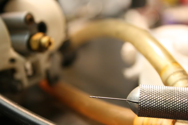

Drill choke to .018, why not .020. Where to drill.
Just keep thinking to your self how screwed you will be if the bit does break.,,,
If I can do it with my fat fingers and a small pair of vice grips on the bit anyone can.
David
I just use my finger with a small drill somewhat like that but smaller.
It's so soft, went thru like butter!
No practice run, no problem for me.
You have to make sure the bit is strait in the drill, it's so small it can easily be seating at the wrong spot in the drill and it gets angled and will most likely break during operation.
