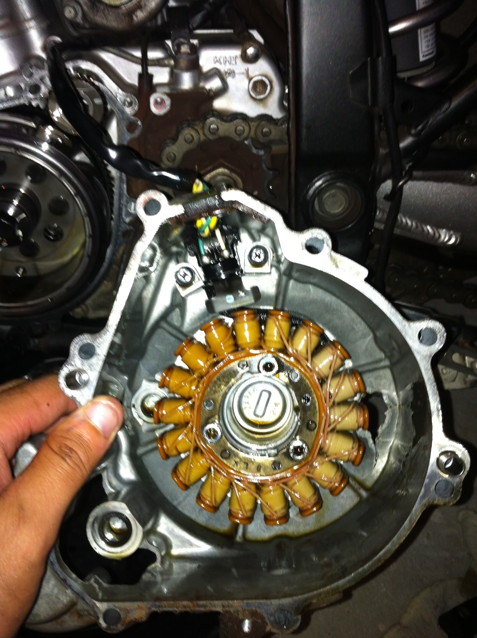

Here's a pic of the stator and pickup on one KF member's 2010 KLX
Not a lot of wiggle room for elongating the pickup coil's mounting holes-which on a 2007 are dimpled on the backside to locate it exactly in place when it's installed.
If I am looking at correctly, the pickup coil mount would have to be moved 3mm CC as you look at the backside of the cover.
