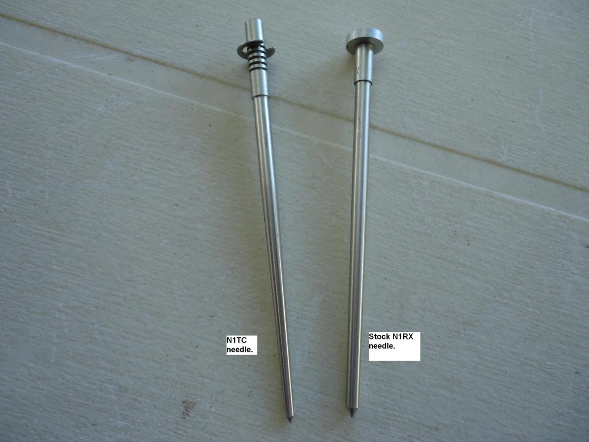

Originally Posted by mmurray70
Anything from kawasaki that will work?
I used a Keihin N1TC needle (part # 160091912), 1x clamp 920371401, 1x collar 921431667 & 1x needle jet 160171368. It pulled all the way the redline with no flat spots; the power gain was unreal. I have no snorkle on the airbox cover.
However be prepared to use more fuel. I went from 145km down to 120km before having to switch to reserve. I reverted back to the stock N1RX needle with 2x shims (part # 920221003) which gave me better mileage & good power.
Hope this info helps.
