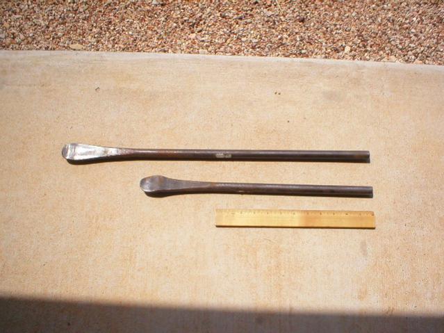

Motorcycle tire changing is 80% technique and maybe 20% tools. A decent pair of tire irons does help. In the shop I use a pair of 14 and 18 inch big irons that makes short work of any tire, but really good techique is more important. Motion Pro makes a tool called a "Bead Buddy" that is super helpful too. It's like a 3rd hand that keeps the bead down in the spoke valley while you're working away with two other irons. Of course all tires aren't created equal either, but a good set of irons and good technique will tame any tire. A Terraflex tire may be the meanest tire to work with, but even it's doable. That's a ruler in the pic with these irons...and no...I don't carry these on the bike.
