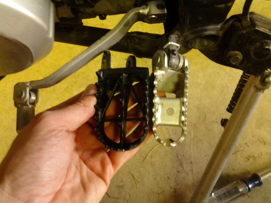

From: Rome, NY
just threw set of drc pegs on and wow what a difference standing much more stable.
