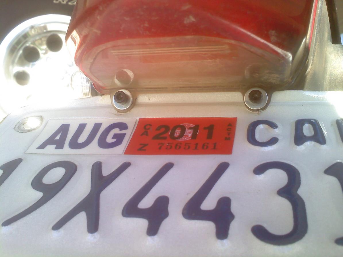

was bored of the same ole look so i got rid of the stock mount and drilled 2 holes where the brake light screws go, drilled all the way threw it and put some 6-32 bolts in there with washers, and nylon locking nuts. just thought i would share the idea =)

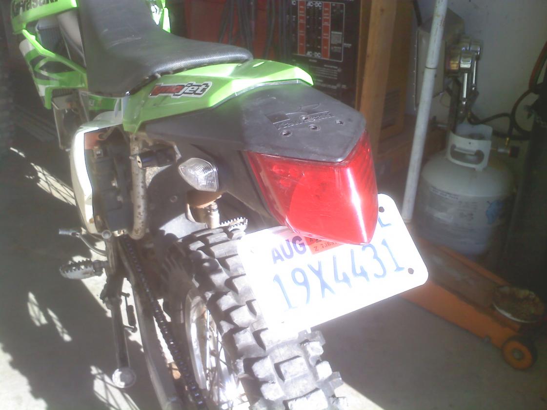

as you can see in the 2nd picture my old plate snapped off while trail riding haha

Interesting. I so very nearly got the hack saw out this weekend and did that but stopped coz I wasn't sure how it would look. I tried to fit a generic LED light but it's mounting points didn't match up nicely so aborted it. Your setup doesn't look too bad. Thanks for posting.

Looks good. Definatly better than stock!
