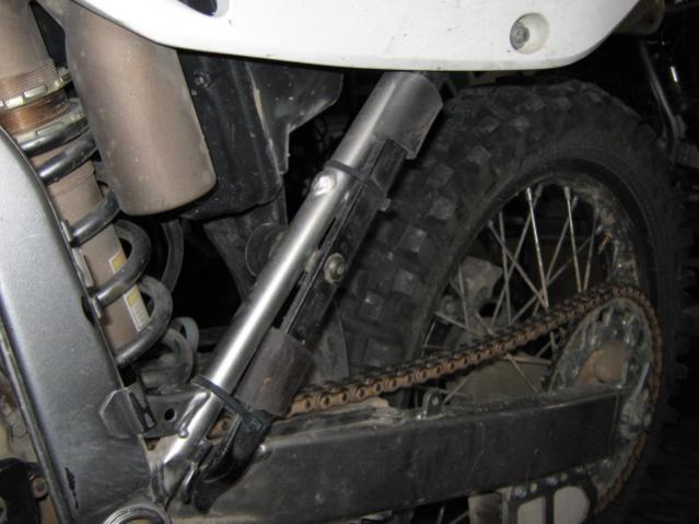

On tire irons, I think we need at least one relatively long tool to get the tire bead removal started and to get the last part spooned in on installation. Different tires either help or aggravate this. The problem is where and how do you carry something with some decent length in a safe but out-of-the-way location? I found that a 14" generic tire iron fits conveniently against the drive chain side seat stay frame member by drilling a hole in the center and modifying the bolt holding the upper chain roller. I put rubber hose on each end of the tool and zip tied it at each end. In over two years of use, I've never had it loosen up, vibrate, or be a problem. If you use this system, you have to mount the tool where it doesn't stress the frame itself. With a central bolt mount and zip ties on the ends, this alleviates any damage or stress to the frame.
I practiced at home in the shop with my tools I carry on the bike to make sure I could change a tire on the trail if necessary. Fortunately with running the Neutech Tubliss system, I haven't had a flat in 3 years, but I know I can do the job on the trail if absolutely necessary.
