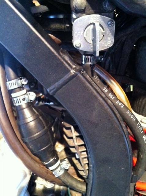

In my quest for a solution, I mounted a flow-thru primer bulb from a snowmobile in the fuel line. A little squeeze on it while the engine is cranking generates enough pressure to override the float valve and raise the fuel level in the bowl so that some gets through the jet(s) and into the throttle body. *
I have mild concerns about the pressurized fuel doing some damage to the float valve or perhaps to a seal, but so far there has been no problem. *We had some horrifically cold temperatures last week (-32c) and I could get the little KLX to fire right up without even touching the choke.
It's sure not the most elegant solution. *It is more of a coverup for the ineffective choke system and/or the ACR. *It also conflicts with my tendency to want to remove things from bikes rather than add stuff, but it seems to be the solution that will hopefully see me enjoying the bike even more this coming year!
I'll report back if any side effects arise but in the meantime I'd encourage anyone else who has not had good results with any of the other methods to give the primer a try.

Image showing how the bulb primer sits unobtrusively in front of the rectifier and behind the starter. Hose clamps and a 10” section of ¼” fuel line are also required. Total material cost ~$10.

That's a pretty creative setup, and I can see how it yields results on cold starting. In an extreme case, you can overdo it and get a "lubrication wash" effect in your cylinder with that extra fuel. Still, probably not a big risk if you only do about 40 or 50 pumps on that bulb.
