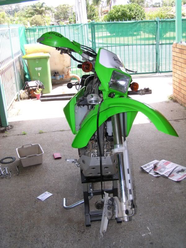

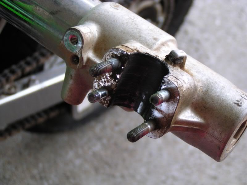

I started to put on my road wheels (motard) did the back ok and was putting the front on, you know those little nuts that hold the front axle in place? Well I broke one of them. I thought damn (to put it mildly) I can get away with 3 for today, then I broke another one. Oh bother I said (yeah right) [:@][:@][:@][:@][:@][:@][:@][:@][:@]
I didn't put a lot of pressure on them as I was using a small cheapo socket set just seems to be they are made outta cheese instead of steel.

I tried to get the broken studs out with vise grips but had no luck, I think it might need heating. I pulled the fork leg out so I can take it somewhere on Monday.

One of those studs/ nuts were broken off of my bike when i got it... i took it back to the dealer and now i have 4 bolts there instead of studs with nuts.... i like the bolt idea better...

Now thats a good idea thanks

No problem, i would make sure those are torqued down to the same torque as the nuts with studs... i use a tork wrench, i have a habit of breaking bolts, i just broke my dads 14 mm socket the other day doing brakes on the back of his impala....
Old Dec 9, 2006 | 05:38 PM
Default RE: Coffs Harbour Toy Run (and a warning for anyone putting a front wheel on)
Those nuts only want a very light torquing - 8.8 Nm. It's real easy to over tighten bolts that want to be torqued that lightly without a torque wrench. Even with a torque wrench set that lightly, you think, "surely they need to be tighter than that?".

That makes me happy I bought a torque wrench....doubly happy that I just ordered the repair manual. [8D] I remember my dealer telling me the torque value for the valve cover..it was somthing that sounded ridiculously low, but when you see what those bolts thread into you understand.

Spose I better get a torque wrench ... I been putting off buying one cause of the cost ... but it's better than being without my bike
