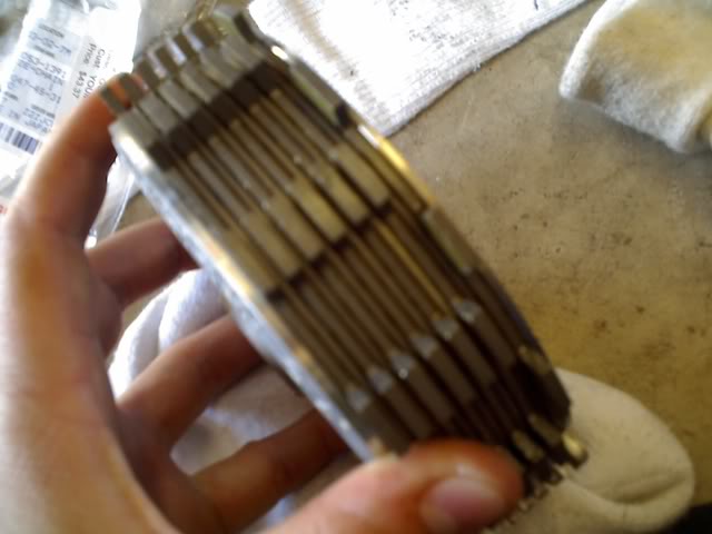

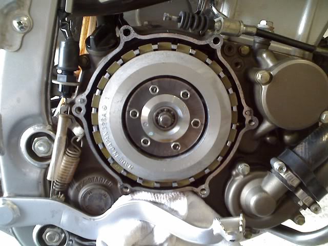

The best thing about a motorcycle clutch vs. a automotive clutch, is the number of plates. A motorcycle clutch has multiple plates (somewhere around 3-8). An automotive clutch usually only has 1 plate or 2 plates if its tuned up. The more plates, the better it gets, and the less chance of the clutch burning up. Also the KLX is a wet clutch, so if you do cook the clutch, you're also cooking your motor oil. Hence one of the reason to change your oil more often during trail adventures.
As for service life? No true guess, but I gotta say at least 10k miles or more. And if it does out, its easy to replace.

Really not that hard to replace.
