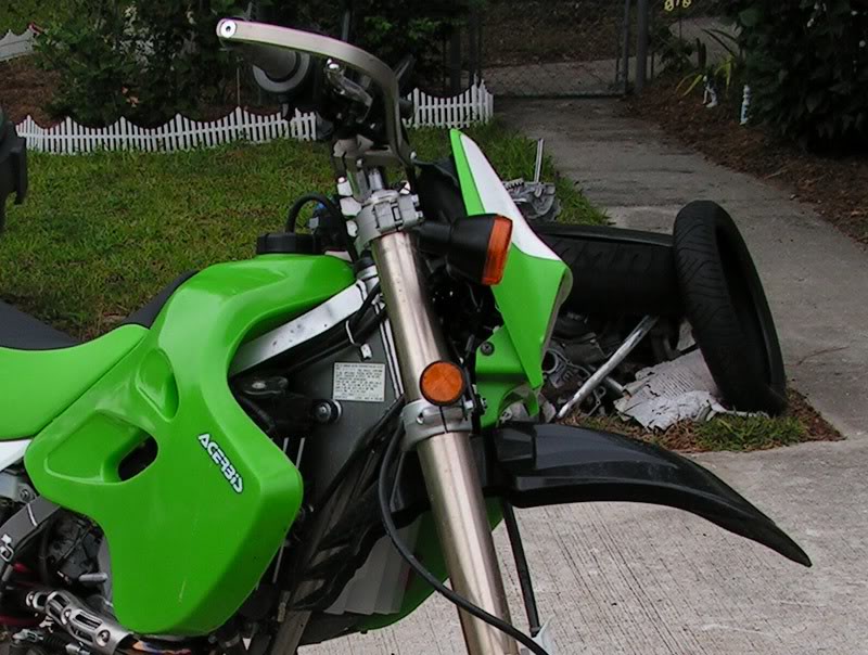

There are many ways to correct this deficit. The most popular is to install a set of aluminum handguards that will prevent the ends being broken off of the levers when the bike is dropped. If you ride in dirt enough, you will drop your bike!
Sorry, but this is about the best photo I have of the handguard available to me at this time. I think you can see how the lever is protected by the aluminum handguard. The bike has been down on several occasions and those at still the stock original equipment levers.
