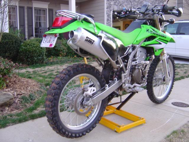

I have the clear LED's that say they are DOT approved. They are bright! I also got the ones for the front but the stalks were too short. They make a longer stalk so, I am going to trade these in for the longer ones. The wires on mine also had to be spliced because the wire that came on the blinker was not long enough to reach. There is no clearence issues and the lights are rubber mounted.

Well, they only come 2 to a package. I have the fronts alsobut need the ones with the long stem so I will have to take them back and trade them in. The blinkers are a much better quality than most aftermarket blinkers. They have 18 LED's in each light and have a nice rubber mount that lets them flex way over. All you need to slow the blinking down is a resistor on each blinker. I have done it on a sport bike and it cost about $1.00 each. I know 80.00 seems high for a set of blinkers but they are DOT legal and very brite.
