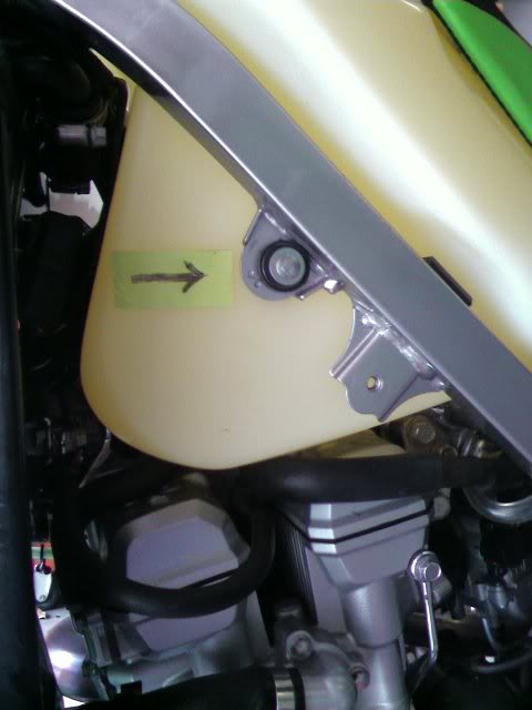

Well the Mole finally broke down a got a Clarke tank!
I sure this has been hashed through here before, but I thought I would share my install experince with you folks[>:] After getting the tank and reading the instructions, it all seemed to go well remove the old tank, drain fuel remove fittings, ect.... then when I went to install the tank I had a fit issiue with the fittingstouching the frame rail so I thought I would shim the back of the tank for clearance (bad idea) now I cant get the seat to fit!
Back to the drawing board so my solution was to enlarge the side mounting bolts to get the tank to move back away from the frame:

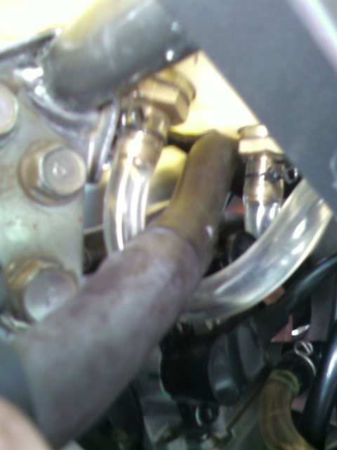

After doing that I seemed to have the clerance for the fittings (poor photo):
And damm the seat fit, no leaks, not real happy with the shroud fit but the extra fuel make the tradeoff ok. Just my 2 cents folks!

I stacked about a CM of washers at the end of the tank, to keep the fittings from taking all the weight of my body. The seat fits on, but the front clip will not settle in (I thought I had a solution, but it popped out) So I just took the screw out of the clarke for the seat clip. No big deal. I took it out for a good bomb in the gravel pits and she worked fine. As long as it doenst leak, I'm a happy camper.

We must think alike! I tried the "stack o washers" method first, which I thought would solve the problem but I just could not get the seat to fasten!

I really wouldnt worry about it. I'm more concerned of making sure the fittings dont hit so hard against the frame that they leak. So far so good!
