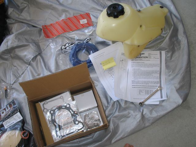

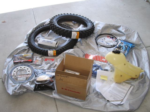

So this collection just got a nice boost a couple of weeks ago when from the local web ads I picked up a brand new boxed Kawasaki OE 300cc big bore kit. AUS $400 and it was mine.
I've tidied the garage and cleared the bench ready for some spannering, and with the fridge stocked with some premium brews I should be in for a few fun afternoons, or late nights (baby dictating.) The nice oversize footpegs have already found their way onto the bike and look very sturdy.

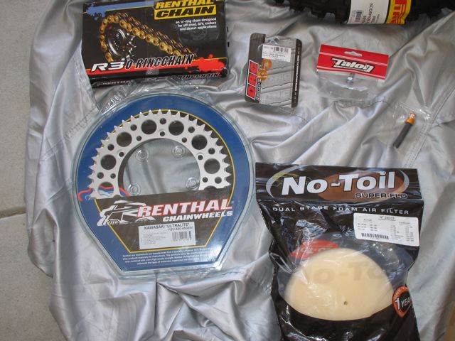

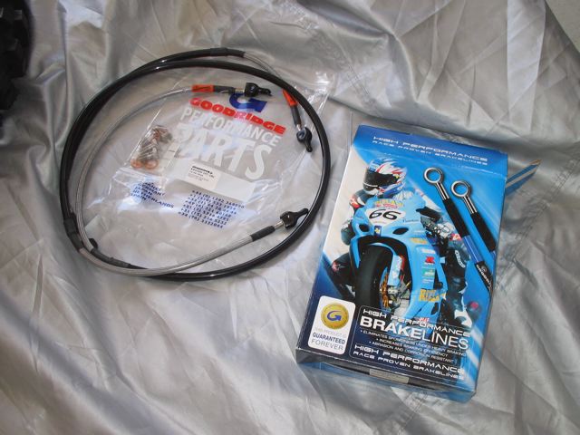

So the list is;
1. OE Kawasaki 300cc big bore kit. Valve clearance check as well so I may be doing new valve shims at the same time???
2. Goodridge front and rear stainless brake lines. (Thanks again pops for the swift delivery.
3. Clarke 10.5 litre clear tank. Gold alloy "bling" breather and new blue fuel hoses. (Thanks Neilaction, and Waitesy.)
4. Renthal R3 'o' ring chain and 45 tooth Renthal rear sprocket (fitted up with the OE 14 tooth sprocket I took off the bike.) Up one tooth on the front as the 300cc will have more torque.

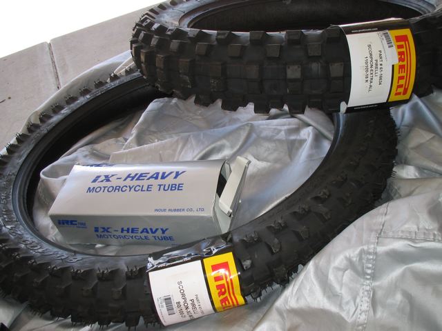

5.Pirelli front and rear tyres. 110/100-18 Scorpion MX Extra rear and 80/100-21 Scorpion XCMS front. Front fitted up with a new HD tube and a Talon billet rimlock. I already have a Talon rimlock and HD tube in the rear. I've ordered some brass spoke weights to balanced the new tyres, So speed above 100 should be a bit smoother.
6. Picked up a N1TC needle and clip cheap, so I'll remove the N1RX I've been using and give it a go once the 300 kit is on.
7. While I'm at it I'll treat the girl to a new NoToil air filter. The 3 Twin Airs I've been rotating are looking a bit ropey so a change is due. Thought I'd give a NoToil a bash as a cheap one literally fell into my lap.
I'll try and get a report and some pics up once bits are fitted up and have had a thorough test. If anyone has any questions regarding supply, cost, part numbers etc. PM away.
So the list is;
)3. Clarke 10.5 litre clear tank. Gold alloy "bling" breather and new blue fuel hoses. (Thanks Neilaction, and Waitesy.)

Ahhh...now I think I see why you were asking about Race Tech suspension mods for the KLX. You look like you're on a wholesale upgrade. Good stuff.
You know...I used an OEM 300 kit for my '06, and I've been extremely pleased with it. Seems like the engine really responds when it has at least the displacement that it was originally designed to run with. No flies on any other big bore kits that I've seen used, and the 351 is probably the best ultimate candidate. Still, the 300 moves the KLX up a notch in a noticeable way, and like you I was able to get one on the cheap. Mine was $200 less than the BB351.
Ahhhh, maaaaaaaayte! I'm so so jealous! I have been using your bike's specs as a sort of yardstick for my bike, and you've just taken a huge leap forward!

Confirm the MX Extra isn't DOT approved? Any reason why you went for the MX Extra over the XC Mid Hard on the rear? I like the look of the MX Extra and the fact that Pirelli rate it for use over such a wide range of surfaces, but because I primarily use my bike for commuting to/from work I feel I really should get a DOT tyre.
Similar question on the XC Mid Soft you are putting on the front - have you mainly done that coz you ride a lot of sand in West Aus? I'm probably leaning towards the XC Mid Hard on the front when it comes time to get a new tyre, but the spacing of the knobblies is a little bit of a concern given how much blacktop riding I do.
Why do you feel you need a rimlock on the front? Do you expect to be running your tyre pressures that low with these tyres that the tyre will move and tear the tube? I'm even wondering how necessary the rim lock is on the rear for the 250 to be honest. With the stock carb I can't see the engine managing to produce enough of a power burst to make the rear tyre slip in the rim - unless you run extremely low pressures. As an insurance policy I'll probably fit one on the rear when I get a new tyre, but wonder if it's overkill.

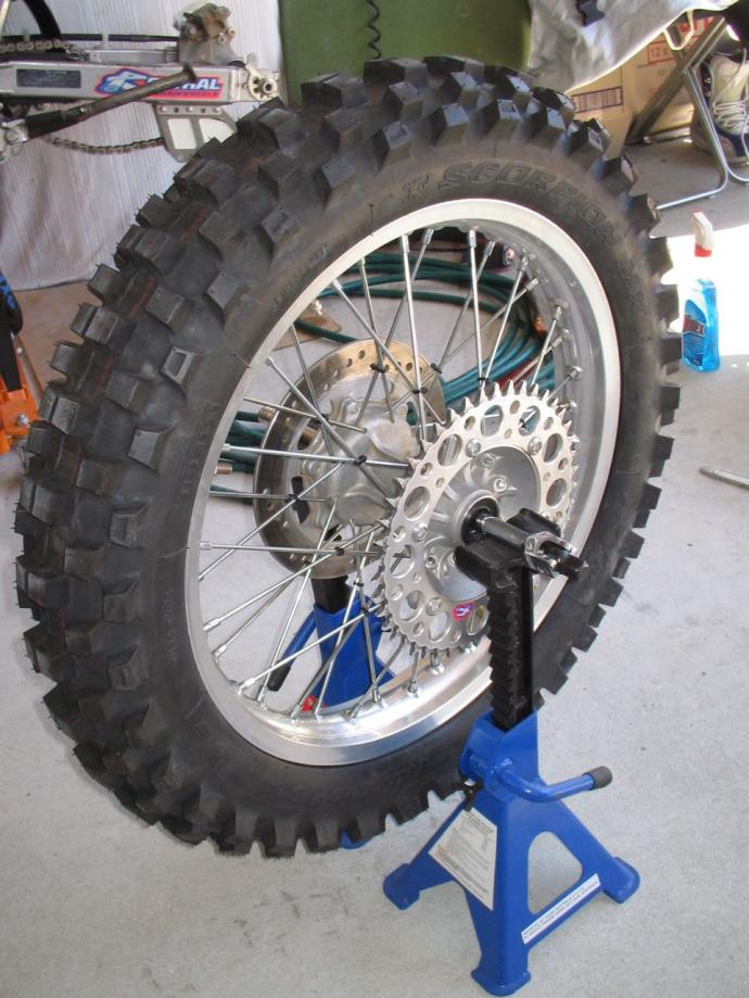

PROGRESS REPORT:

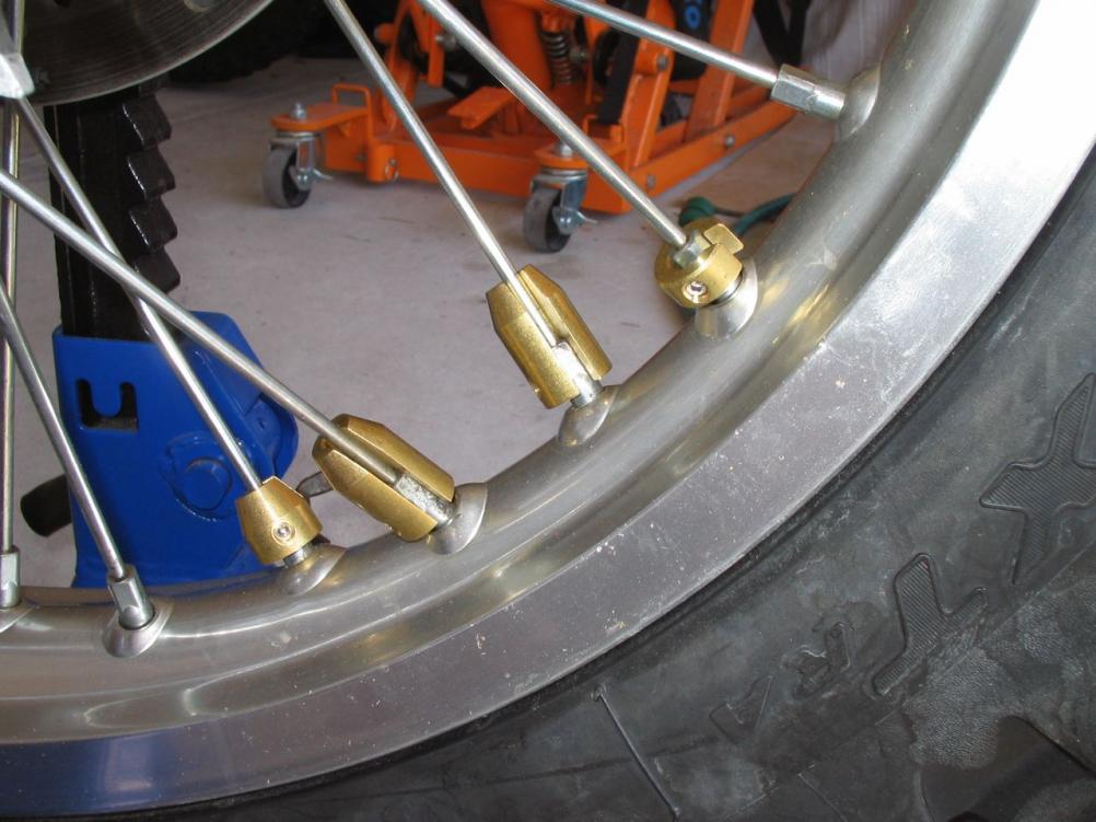

Got the rear tyre fitted up yesterday. The shop had the wheel for a few days taking out a very large ding acquired while heroing some clay erosion mounds some time ago. The rim stayed true for over 4000 km but with a small gape at the tyre it was letting some dirt and water into the rim. They did a pretty good job, torqued all the spokes on the rear too, and replaced 1 nipple. All for AUS $35.
Fitting the tyre was pretty straight forward (practiced with the irons quire a few times over winter.) As I have a rimlock on the rear, and an HD tube I wanted to balance the new tyre. (I was getting some gyration when the speeds got up above 100km.) I purchased some brass spoke weights from AEROstitch (http://www.aerostich.com/prevent-or-...e-weights.html). Great service BTW, and prompt delivery. (No affiliation.)

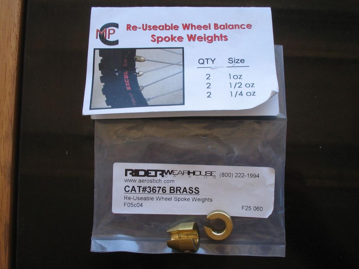

I weighed the Talon 2.15 rimlock I have and it came in at 76 grams (2.6 ounces.) I figured that with the weight of the HD tubes valve I need 2.75 ounces (78 grams) of weights to balance the rim. The weight kit comes with 6 weights in brass (2 X 1 oz, 2 X .5 oz, 2 X .25oz.) I used both the 1 oz and 1 each of the other sizes to make up the required 2.75 oz.
I made up up a rig for balancing the wheel using some axle stands and my short power bar. Adding the weights to the spokes opposite the rimlock had the wheel balanced pretty quickly. I first dry fitted the weights to get the balance. Yo have to remove them and refit with some blue Loktite on the weights threads once you have the correct balance.
Nice way to spend an hour or so on a sunny spring morning.
I'll do the front today with the same method, although the front tyre is DOT and has a "red dot" on the carcass to show the tyres light spot. It may not need as much weight to balance. I'll set the tyre with the red dot next to the rimlock.

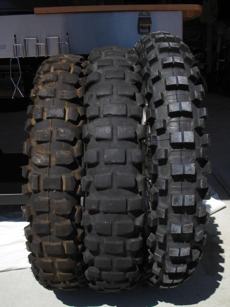

Out of interest. I put the new 110/100-18 Pirelli Scorpion MX eXtra up against the old Dunlop tyres I had. The one on the left is the OE Dunlop D603 in 4.6 x18 and the middle is a Dunlop D606 in 120/90-18. You can see that the tyres get progressively taller (left to right.) When I first put the 606 on I noticed the bike was a bit taller and had the stand less stable when parked on the slab. The new Pirelli looks taller than the 606 even though the 606 has no ***** left. Hmmmmm!?
I think I'll order a set of those weights and try balance the tyre myself. When you spun the wheel on your DIY balancer, what were you looking for to determine you had the right amount of weights in the right position?
