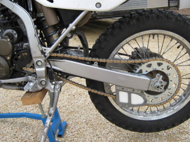

Yeah, I know the manual says to check slack with the bike on the side stand, but honestly my bike has some static sag when on the side stand. And near as I can tell, it's never quite the same. I'm a lot more confident of my actual chain slack when the bike is on a small lift stand. With that the rear wheel will drop to full extension, and the slack will always be more consistent. And as IDRIDR suggested, it's wise to check the slack in several places, as chains are seldom the exact length throughout all the links.

Yowsers. This sounds more complicated than it is. My method is to sit the bike up vertical and off the stand. I stand beside the bike on the right side and lean over the bike trying to compress the rear suspension as much as I can. I then grab the chain on top of the swing arm and try to get a healthy inch of freeplay.
On TNC's photo I would say that it is too loose but wouldn't know until some weight was on the bike.

Highbeam, I agree that it looks loose. I run a 14/47 gearing, so instead of just going with the recommended 55-60mm setting, I cinched the suspension down to that countershaft, swingarm pivot, axle alignment point...tightest point...and set the chain slack at a safe minimum at that point. When I released the cinch strap and with with wheel off the ground at full extension, my optimum chain slack turned out to be 60mm. 55mm would have been a tiny bit too tight. Where you have your axle adjusters and chain length set can also make a difference, of course. My chain is running at an ideal tension at 60mm at the recommended measurement location on the swingarm.
