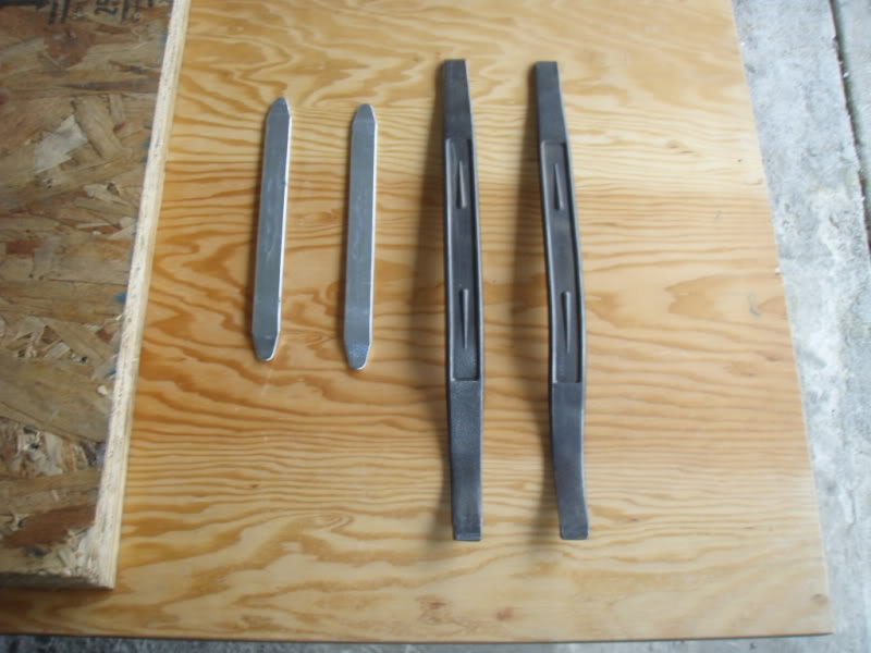

Old Mar 18, 2014 | 10:36 PM
I have these and take them when I'm in the middle of nowhere.
