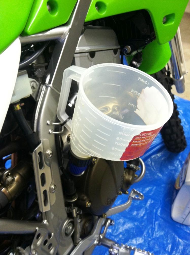

I think it took 5 minutes. I was wondering how I would balance the spout and the gallon of oil and measure it out and not make a mess.
I had a funnel with measure lines and also a dial that allows you to turn off the flow. I have a billion zip ties I try to use at every opportunity and this worked great. I filled the funnel with one quart and then let of drain in while I got my torque wrench and tightened the plug. I added more and with this zip tied funnel I could tip the bike straight to make sure I was all full. Worked perfect.
