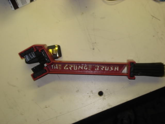

the grunge brush!! a little kerosene and wd 40 mix and this three sided baby makes chain cleaning easy

Who is "they?" The Grunge Brush mentioned by Hoedog cleans the chain while it's on the bike and is highly recommended by Web Bike World.
