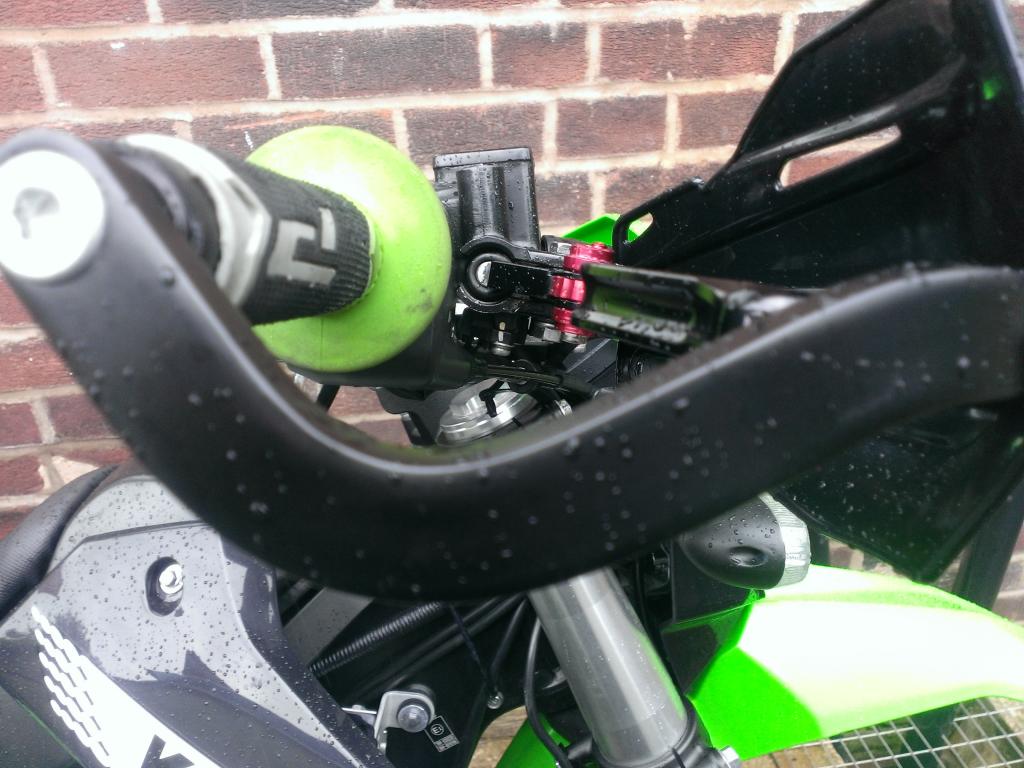

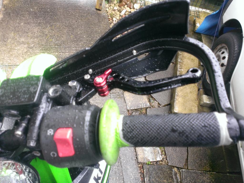

I've had mine on a few months and they seem to perform as well as the stock levers.
They fit to the perches well, the only issue i have noticed though is the brake light doesn't come on when squeezing the front brake lever, any one else get this?
Also I've not had anyissues with paint fading etc etc....

I'm guessing the pin in the switch is stuck "in" from looking at my '09 with those levers just now. With the brake applied try getting in there with a big safety pin and flick the pin out.
