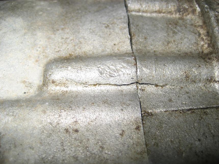

I tried to put an image up. not sure if its gonna work. anyway i drained the oil and i might spray it real good w/ carb. cleaner and brakleen then i might try to weld it. I am a welder fabricator for a living so i'll see what happens.

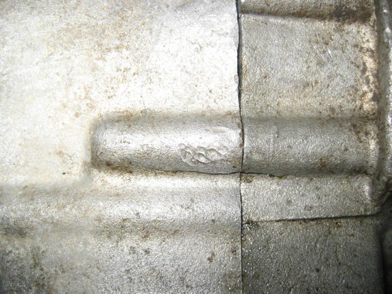

Here is another shot of the crack. Does anyone know how this might of happened? I'm convinced the guy before me was a ****ing Monkey.
"I am a welder fabricator for a living so i'll see what happens." And you asked us on how to fix it!?! Dude, bring out the torches and MIGs, and start welding. A TIG welder would be really nice for that kind of fix.

wow, that is a Grand Canyon of a seam let alone the crack next to the bolt. That and there is alot of porosity in the main casting itself. I hate JB weld and baleing wire, so I agree with attempting to back the bolt out, cleaning, tig weld the crack, re tap/chase the threads since the heat would have distorted the original threads and retorque the bolt in. Good luck

I think thats what i'm gonna do, clean it real good and tig it. I never used JB Weld so i was wondering how it worked. (it's usually a welders enemy)

I'm not sure i follow you,,,, are you going to weld it without disassembling?
That would be a mistake. It doesn't even appear that the cases have a gasket in between from the photo. Anyway, if you are a welder, and not a good mechanic, have someone tear it down for you and do it right.
I think someone tried to split the cases and forgot to remove this bolt, that's the only way i can see it cracking the way it did.
