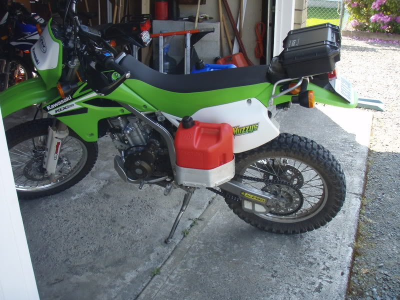

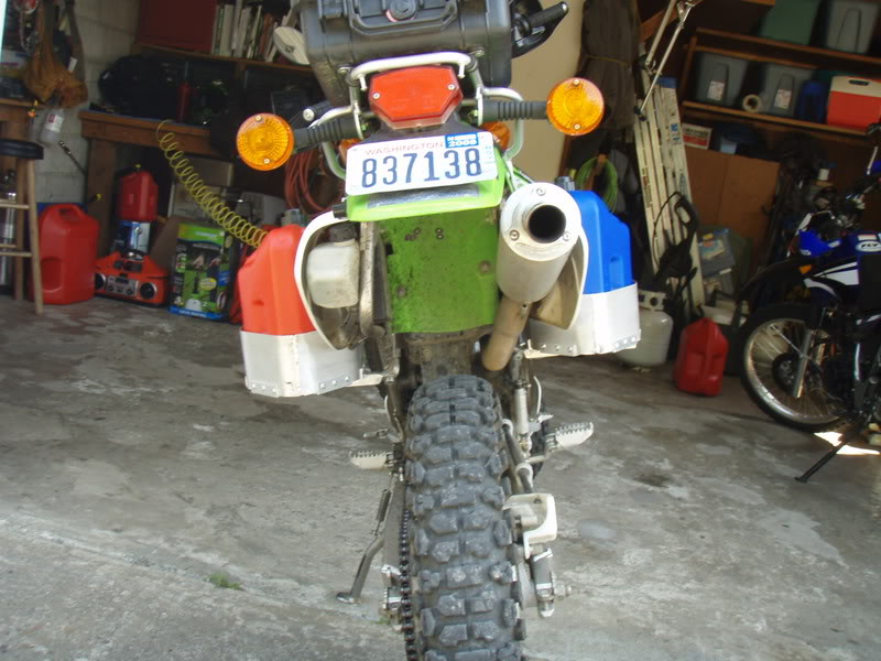

Originally Posted by axel
Da***** and apologies again. I reset my files to public (again) logged out of photobucket and used the link on this page and could access the images. I hope that it's fixed and useable for all now but someone let me know please if they cannot get into see the images.
I''m in!!! Looks like a nice setup. I'm getting thirsty just looking at it

I got in now. That setup looks great. With that fairing it looks set to do a DAKAR. (aside: The 450s actually put in a good showing in this year's run, a 351 might be a bit small though) Looking forward to your ride report.

I like your solution to the water carriers.

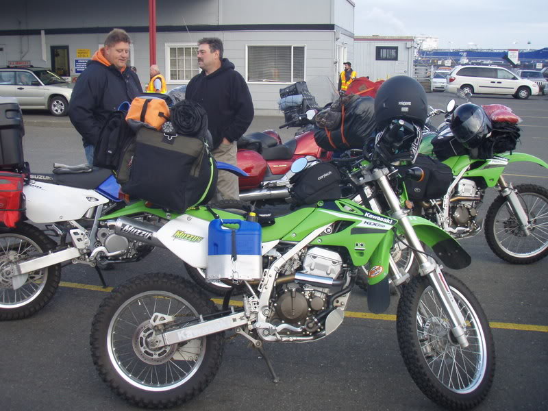

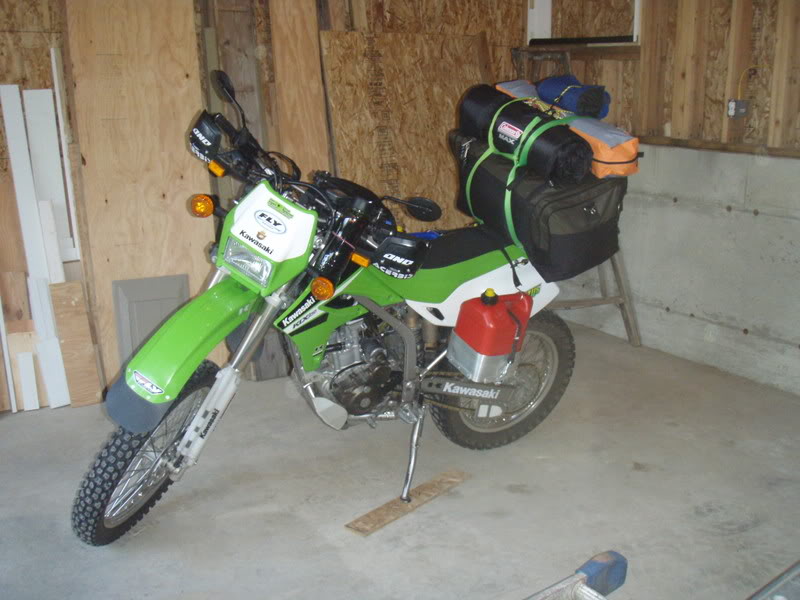

Looks awesome! Sorry about the wobble, but I'm sure you will figure it out. Here's mine. Love to see other ideas.

Hey Deej do you have the stock spring and fork spring on your bike? That load you have must be as heavy as I was carrying.
Old Mar 19, 2010 | 07:59 PM
Yep all stock, adjusted to the max, and if you think that's heavy, check this out! LOL
