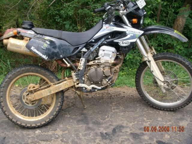

On that trip which i posted pics of I had done 700Kms total and I had pumped 35 Litres of petrol total too.. So that means my bike only does 20 Kms per litre or 45 Miles per Gallon.. Which is RIDICULOUS!!!
What do you think the problem here is?

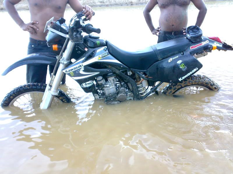

Recalling the fatal day. Looks like you had some serious water ingress. LOL
Seriously though, that has got to be checked out. You'll need to make sure all the water is out of the oil. Check inside the stator cover (left side) as there is a real risk some water has got into the charging system. From the photo I can see you pulled the carb' breather hoses up. Did you try running it while it was that deep in water? I'm convinced your trouble is from water in the bike. A new plug would be good. Check the spark as I detailed earlier. I'm convinced you'll have to flush the oil, maybe twice or more to remove all traces of water. How was the bike performing before you drowned it?
Use that performance as a benchmark. Getting everything to work as it should after a good soaking can be a trying time. Just be thorough and make sure all the affected parts of the bike are clean and work as they were designed.

Hey man, before I put the bike into the water, the problem was there.. No difference at all.. So the water isnt the problem.. Theres no difference in the performance before or after the water run.. Its exactly the same..

Im not worried about the water, because it didnt affect the performance at all.. The problem is definitely jetting.. Because, when the bike was all stock it didnt have any problems.. All the problems came after the jetting kit and running without a air box lid/snorkle..
