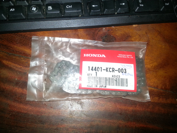

I got this today, says made in japan. im not sure about that. Price $50

the Honda part # is borg-warner, which is unusual as you'd thing they'd source from DID ? same with my crf I just rebuilt B-W oem part.
