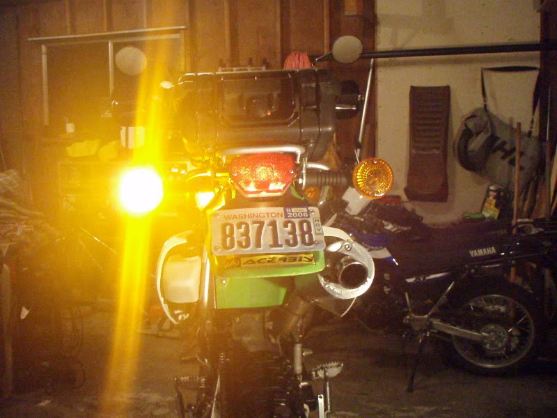

Yep, I had it happen, but that's because when I first took off the stock ones to replace them with the smaller ones, I bent the tabs in to hide them, then when I pulled them back out to install the stock ones back on I could feel the metal weaken....I knew it was just a matter of time. Then I got smart and realized that the stock ones were 5 times brighter and I decided that life was worth more than looking cool.
Here's a picture showing the difference between the smaller ones and the stock ones...just for reference.

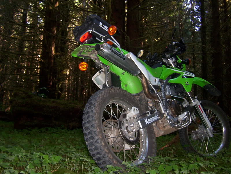

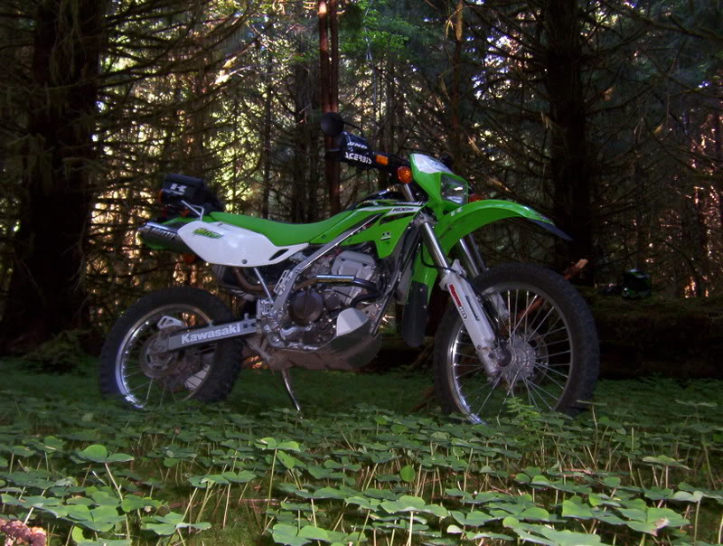

Anyway, here is a picture of one of my blinkers dangling down. I can still remember it from 2 years ago, I stopped in the woods to take a picture and the bike fell over and snapped it off.
You have to admit, it was a cool picture...except the broken part. LOL
