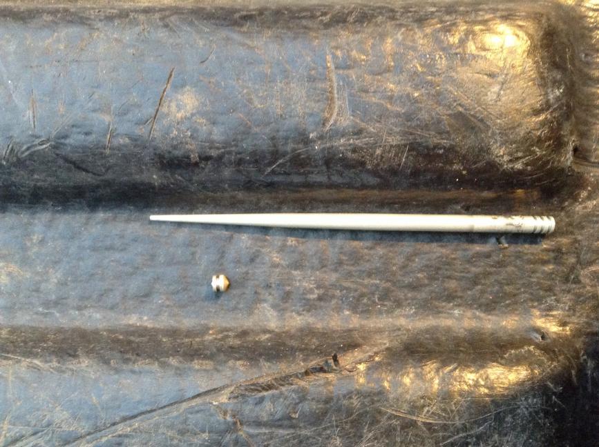

Mine did something similar last week. I found that my needle in the carb had broke where the clip was attached
