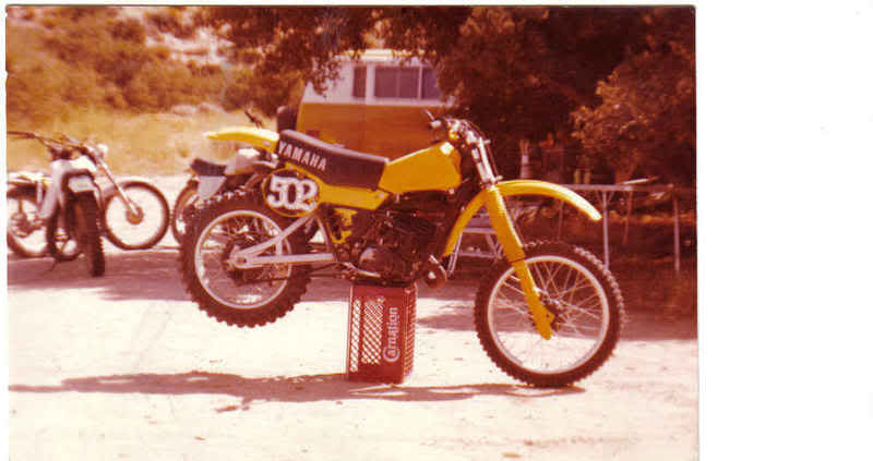

Old May 5, 2015 | 04:32 PM
IDRIDR's Avatar
Posts: 4,507
From: SW Idaho
Old May 6, 2015 | 11:33 PM
MaximusPrime's Avatar
Joined: Mar 2012
Posts: 1,266
From: WMNF, NH, USA
Notice the metal band?
They don't make milk crates like that anymore.
