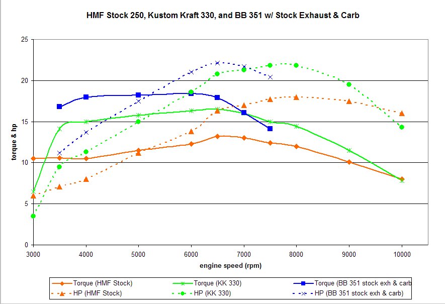

Well said. Is there any similarity in the actual power curve readings from dyno to dyno. Peak numbers seem to vary due to many different conditions, seems the curve would be pretty consistent to your setup. Dyno experts please chime in.

Now that you mention it that KK stock dyno does look a couple HP low. 18 is a fairly common HP figure thrown around here for a stock bike.
Ya, I noticed that on the KK stock run, which makes me think that motor may have been a bit worn or at least not running at peak tune & performance for the stocker. If "old" was a good representation of an unmodified stock KLX and the increase from "old" to "330" are the comparative values, than does the 330 put out more power and torque than the 351? I think not likely.
I'd like to see one of BB's dyno runs with the modified exhaust. I believe it was posted on his old web site, but I didn't keep a copy.

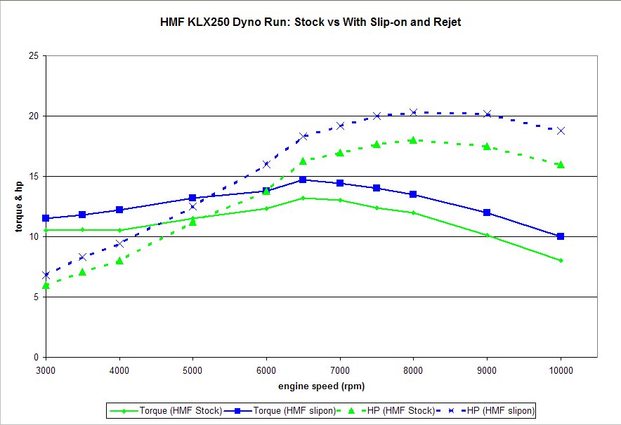

If HMF's dyno runs are a good representation, than an improved exhaust and re-jet are significant.

At what point in displacement does the stock head/cams restrict performance. The way the 351 drops off after 6500 rpm makes me wonder. Nice work combining all the dyno graph info.

Agreed and good point. But remember Bill's 351 curve was still using the stock exhaust and carb. I think most around here agree the stock exhaust is very restrictive. It's not clear if the carb was rejetted. I assume it was rejetted although he just calls it stock carb.
And to the good points TNC makes above as to trailability, I don't generally wring the motor out so the 351 works well for my use. I'm trail riding, not racing. Don't spend much time above 7,500 rpm.
