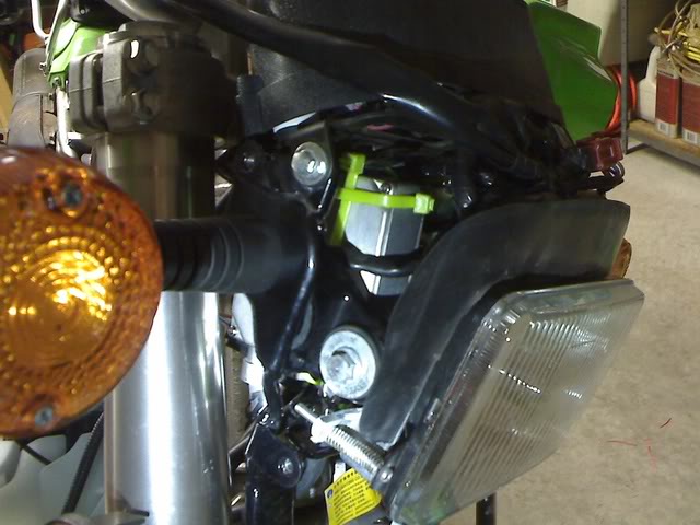

I got the HID kit in yesterday. I was so joyed, I installed it the same day. It took me 4hrs just trying to figure out how and where to put everything. The ballast was the hardest thing to find a place, but I did manage to find room (just enough room) in the headlight shroud. After said and done, the lighting is a worlds difference. Made the old halogen look like a flashlight with dead batteries. But I also did come across a few problems. One problem is that there is a V-spread of the light. I suspect the bulky front sheild of the HID is to blame and is still a simple fix. Just remove one tiny screw and pop off the front light shield. The major problem I encountered was that when starting the KLX, the HID lamp would sometimes fail to light. Due to the excesive voltage drop when starting. I'm thinking two fixes for this. Either A: Add a capcitor to the HID wiring, or B: Add a manual light switch so it can be turned on after the engine has started.
Now for the bad news. Since I finished around 2300 (11:00PM) and was not thinking right after a few mountain dews and ice tea. Since the lamp startup would sometimes fail. I removed the whole HID kit from the KLX, so its back to halogen. So once again, I'll have to do the kit over. But it will give me a better chance to do a write up. Plus, since I already figured out where everything goes, it will be faster to re-install.
$105 with shipping included. And you get an extra Xenon bulb and ballast.
Originally, the kit was designed for a car. I'm retro fitting to make it work on the KLX. Everything is pretty much plug-&-play. All I've done to it so far is remove the second bulb harness.
I've thought of a plan C. If I can find a relay that stays closed circuit when not energized, and open circuit when energized. I'm thinking I could splice into the starter button so the headlight shut-offs when cranking the engine over. Once the engine starts and I release the starter button, the ballast reconnects and starts the HID headlight again.

I found the relay I needed. It was a SPDT (Single Pole Double Throw) relay. Which will allow the circuit to be closed until the relay is energized, then it will open the circuit.
Tonight I'll try to get the Halogen photos as the before shots. And then do the conversion and get photos of that. I'll most likely be doing the conversion, again, on Saturday.
