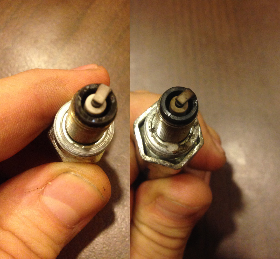

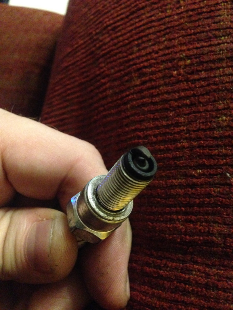

So today I pulled the plug and here's what I got:
I would say it looks "dry fouled" or "carbon fouled". I had the original plug the bike came with and used it as a test. Took the bike out for a few minutes and here's what I got: (before pic on left, after on right)
In only a few minutes that plug became a lot darker.
