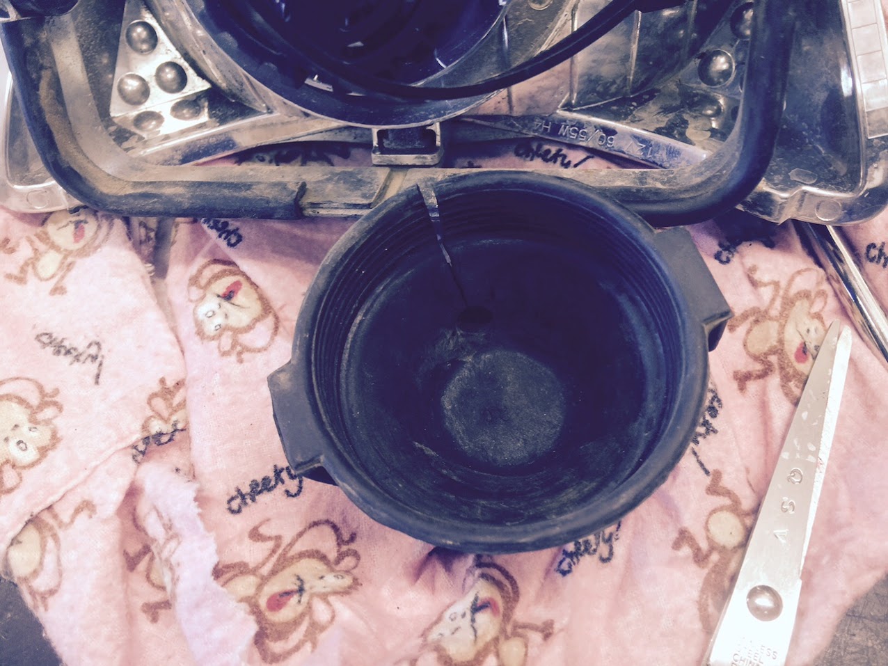

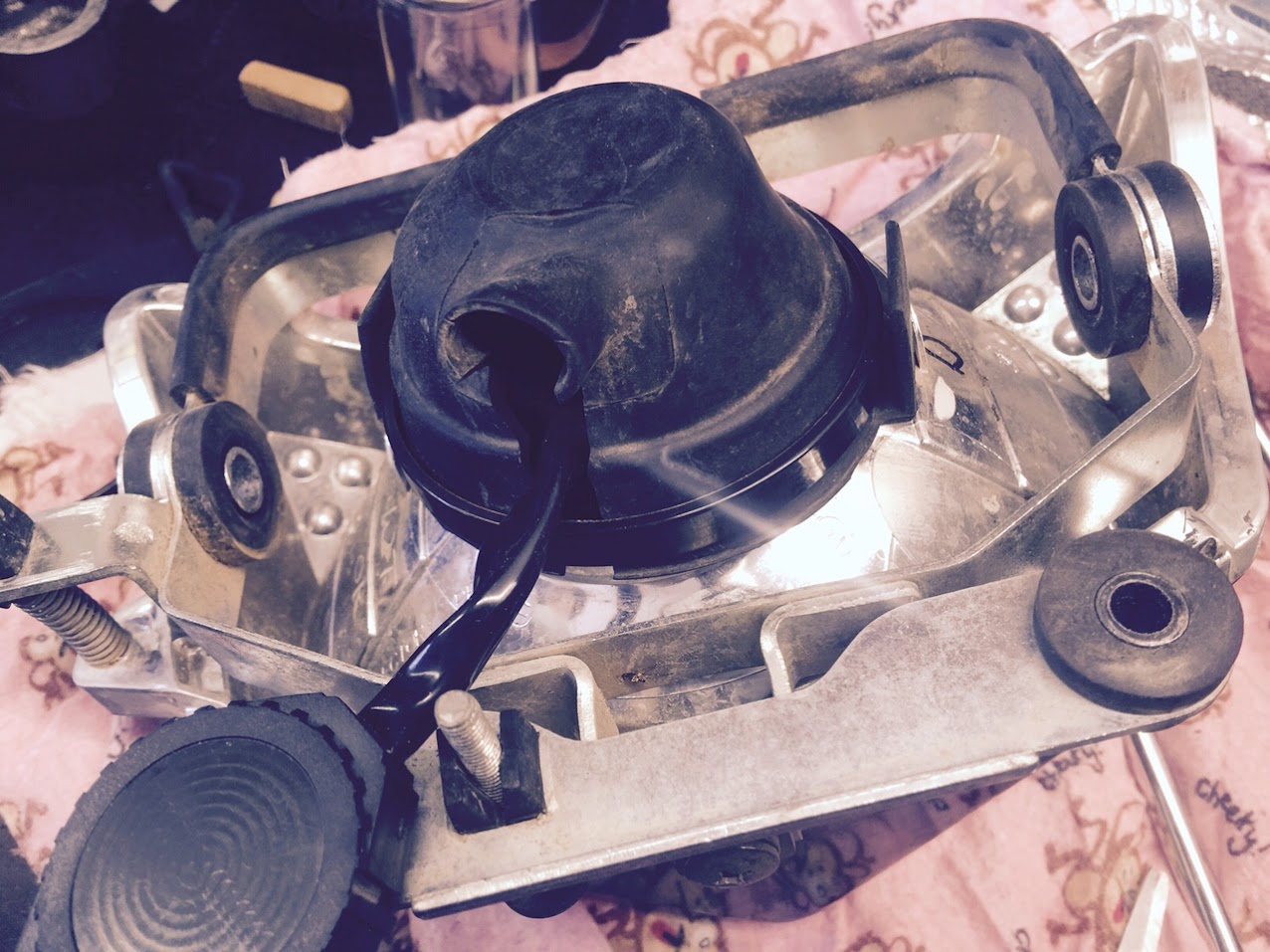

I installed the cyclops 3800 H4 LED bulb. I cut out a circle in the back of the rubber boot to provide airflow to the cooling fan. So far, working very well and super bright! The only downside: some moisture now gets pulled into the headlight assembly when riding in the rain. I may silicone the bulb mount to keep the water out.
You may have better luck with the 3600 lumen bulb which seems to have a smaller base.

I've changed the way the boot seals the light and it is better now. I enlarged the hole in the rubber and folded it back down under the cooling fins. This prevents the fan from pulling water vapour into the headlight.

just installed one of these on my '12...... went real easy. it all fit quite well into the rubber boot. I just had to cut it open long the small hole since the cabling doesn't fit through the hole.

the pattern seems ok, better than the halogen anyway. It's hard to be subjective plus find somewhere dark enough to make it stand out real clear.
the boot doesn't really seal at all anymore, the bottom of the cut is open. I made sure that it was at the bottom though.
