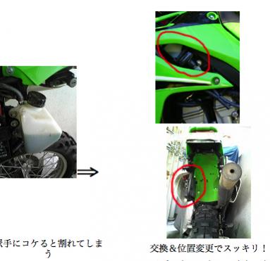

This is where they put the expansion bottle in Japan.
Thanks, mate.
We are supplying a bottle that can be tucked in several places, so don't worry about that. It's only really the helmet lock that is displaced.
I should apologize about the 1.1 tank for the '09, we ran into an issue with the bracketry. The frame tapers with the new rear plastic section, and that meant a new aft bracket. The middle bracket has to have a rubber lined frame clamp added to it, and the location of the front bracket is changed also. So, I'm in the process of also building a separate weld jig to make the different set-up but on the same tank.
Bill will be in Colorado for the next 10 days, but I will continue to get it built. We WILL have it for the '09's. I changed the website to reflect this delay.
