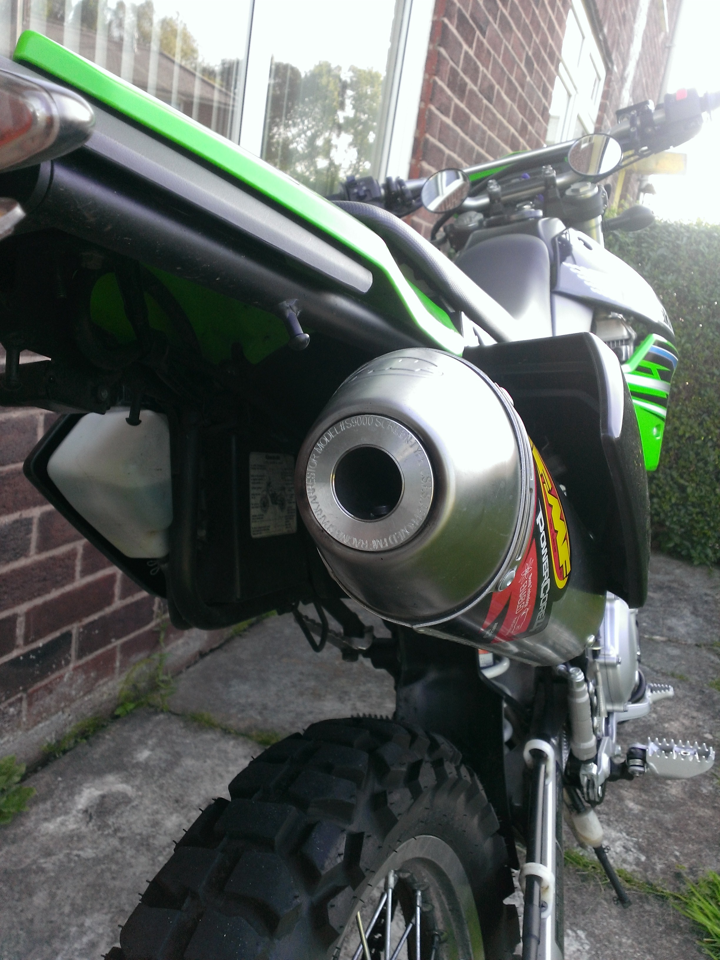

Originally Posted by Werloc
I don't have an Q4. I have a Powercore4 muffler and need a quiet insert with spark arrestor. I don't know what one to get. There are many listed, but don't know which one is correct for my PC4...?
Didn't mean to hijack this thread.
part #040630 fits the power core four
Attached Thumbnails Anyone have a Powercore 4 Quietcore insert 040630 you don't need?-wp_20130711_011.jpg
