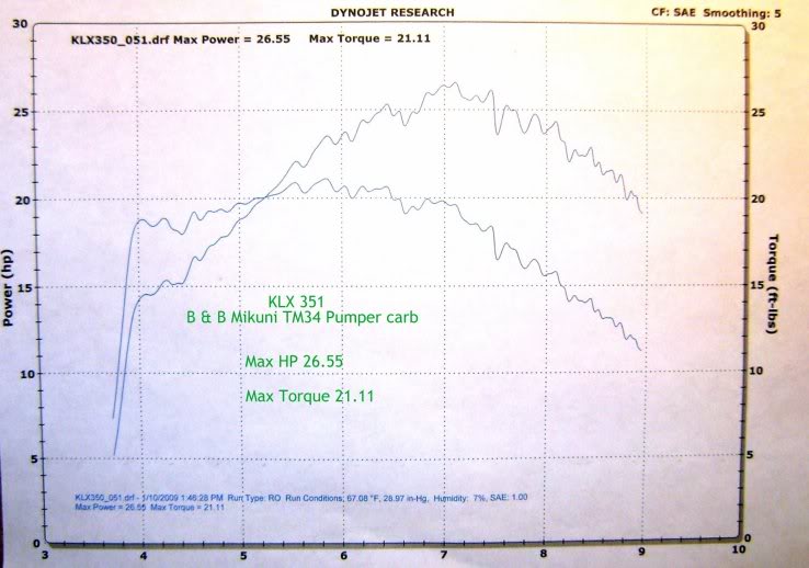

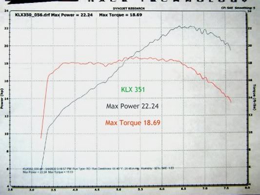

He (BB) has a dyno chart on his page showing the 351 kit with the stock carb on.
Mikuni carb results

Kobra and work, I have heard this from many experts and engine builders. Different dynos can produce some notable differences in power readings, and they warn about making exact power-to-power comparisons from different dynos. I don't know how much stake to put in this, but I read and hear it all the time. They always seem to say that you have to use the same dyno facilities to track finite changes that modifications bring to the engine. Take that for what it's worth.
Kobra, I believe those charts are the one's used by Bake and Bill from the huge thread over on ADV when they were developing the kit. The carbed chart was Bake's bike and the pumper was Bill's. They were not exact in their other modifications for each bike, so you might not be tracking exact influence from the 2 different carbs. I'm not trying to trash their results, but perhaps an exact comparison of the pumper carb's influence isn't 4 horsepower. If I'm wrong here, please clarify.
