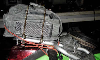

Isn't there enough room under the left side cover to rig something big enough to carry a tool pouch? I can't see the front fender very well but there looks to be a notch down the center under the headlight. Is there room to secure a tool pouch there? I really like my Maxpedition pack but my 06 has a rack that it attaches to. What about something like a maxpedition bag lashed to the front headlight shroud?
You could lash a pack to the rear fender with a rack but it might take drilling some holes or adding some attachment points. My pack carries my tire kit and has allot of left over room and compartments plus it expands of compacts depending on what I need to stuff in it for the day.

Hm, that bag on the rack is 180 out from what I'm trying to do. I thought about the airbox lid, but then I remembered I'd need a 8 mm socket to get to it. D'oh. Too bad we don't have the quick-snap thingies like alot of other bikes have on their side covers. I'm thinking there might be enough room between the puke bottle and the rear cover to slide the tool pouch and the paperwork, maybe inside of a larger pouch to protect it. Attaching it would be a puzzle. Behind the number plate might work out.
