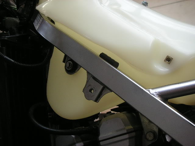

Even though i had issues with the way it fitted in relation to the frame rails, I've had no problem with it.
I'm sure it should be sitting on the rail as the stock tank does.

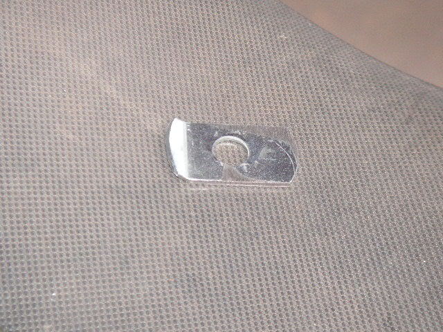

I also had trouble with the seat popping out of the tank clip which i found a real pain in the dirt as the front of the seat moved around.
Fabbed a elongated washer which did the trick.

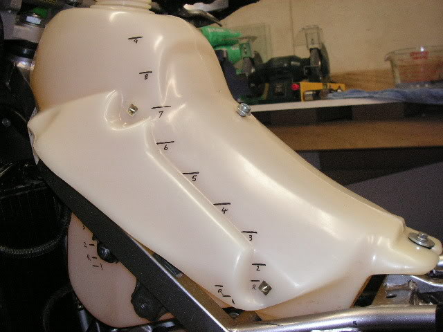

Poor mans fuel gauge.
