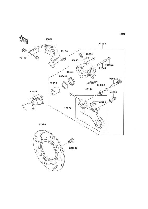

What is the anti-rattle spring? Where does it go? Anyone have pictures to share?
I had a tube failure in my rear tire so, considering I have 9500 miles on the factory pads I decided to change them while the rear tire was off. I took the long pin out that holds the pads in the caliper. I never noticed an "anti-rattle spring". Did it fall out in the parking lot and get lost?

I think its part 92144.
That's the only spring back there.
