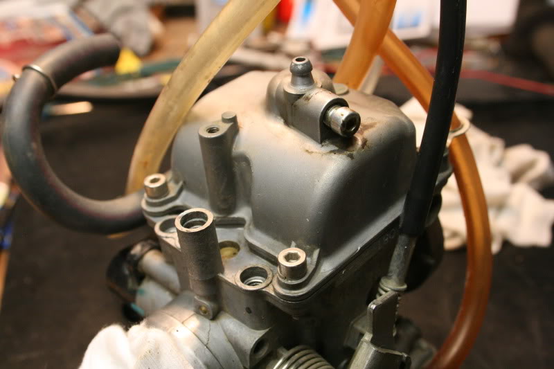

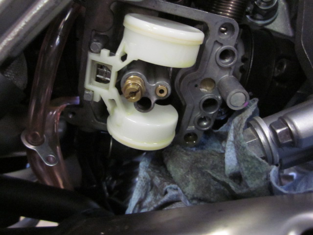

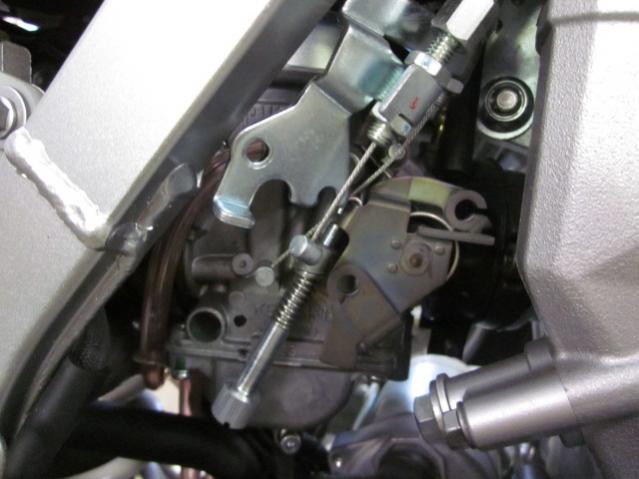

Having work 32 years as a Ford tech I have learned there many ways to approach a problem so presented with the task of drilling out the idle mixture plug and starter jet I set out to find a easier way to access the carb. I removed the screw holding the cable bracket to the carb body ( make sure to use red Loc-Tite when reinstalling this screw ). Next I loosened the 2 carb clamps at intake and air box. Remove host on the front top of carb and turn the idle speed screw in 3 turns. now spin the carb 1/4 turn counter clockwise and the bottom of the carb is now easy to access without the hassle of removing it. Total time to get the carb bowl off and drill out the plug was under 10 minutes.
