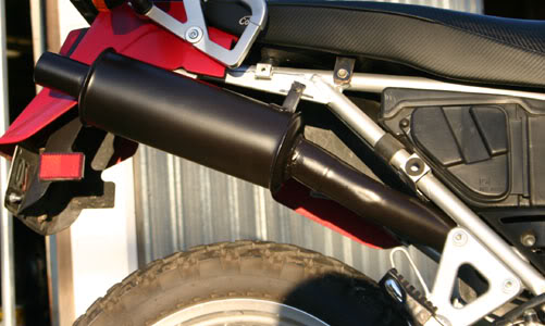

I have a couple of questions maybe someone might answer. Does the KLX300 exhaust fit on the 2009 KLX250? I found a tail pipe I might consider picking up. In addition, anyone here use one of the Chinese knock-offs that are like the FMF pipes yet?
I'm still thinking a "John Deere" slip fit on a head pipe:
