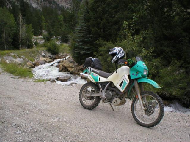

Originally Posted by Wsc7050
I would get one of those bikes, but I don't want to have to tell my parents I'm gay.
Yes, you are gay if you have a KLR650...especially this color.
