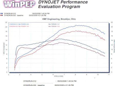

Default Dyno Chart
Here's a dyno chart from an HMF forum, see post #3:
Kawasaki KLX 250 slip on - HMF Engineering Forums

The dyno chart I looked at for the SF, which should be the same as the S model, was only about a half horsepower...wasn't it? DJ's charts are all with a basically stock bike and exhaust unless they indicate otherwise...aren't they? I'd think the half horse increase on the 250SF chart is a bone stock SF with "maybe" the airbox lid off. I notice on the KLX300 it picked up a full two horsepower with the kit, and I would guess with the airbox lid off. Anyone have a different take on the DJ charts?
My take on the DJ kits as applied to a bone stock bike is that they are more effective for driveability improvement than absolute power gains. Pure off road models like the KLX300 probably get a slight power boost since they're not as restricted in bone stock condition and so respond better to the improved fuel/air increase. That two horese increase on the 300 is decently impressive for just a DJ kit and perhaps the airbox lid off.
IDRIDR, on that HMF mod, it didn't look like they drilled the slide, and it looked like a stock needle. I don't know...the stock needle kind of sucks from my perspective. Maybe the comparison with other charts might not be as good a comparison.

TNC: Yes, that's my take. HMF shows slide not drilled and stock needle shimmed up. On drilling the slide, my assumption is that the drilling the slide improves throttle response, but does not improve horsepower. Do you agree? And on the needle, I'm assuming that the better DJ needle may help the HP through it's applicable range, but that the DJ's needle's real benefit is in driveability, as you suggest.
What I see from the HMF posted dyno chart is the improvement from a better flowing muffler, opened airbox (snorkel removed) and a larger main jet yielding 2+ ponies. That and a fairly good "how to" on removing the carby. Does the DJ needle improve HP in the mid range?? I think so...probably...but I haven't found the charts that prove it.
