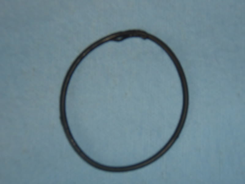

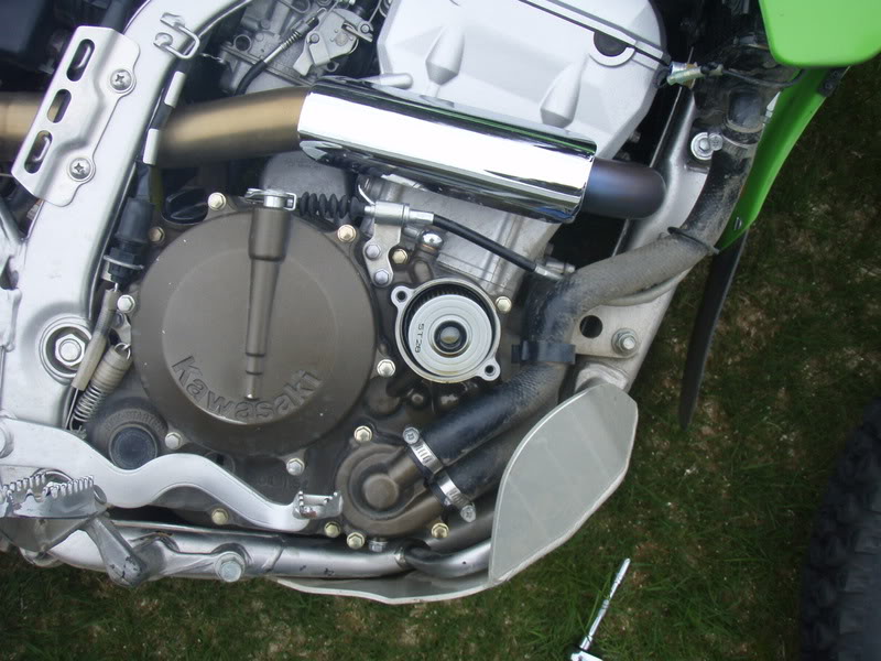

Ok so I stopped by the auto parts store to pick up someAmsoil 10w-40 Synthetic oil, and head home to do some springtime maintenance. I drained the oil, pulled the filter, and installed the new filter and filled up the bike, and when I went to start it oil came pouring out where the filter cover is. Well it turns out that after 10 oil changes using the same o-ring, it decided that today was a good time to get pinched.

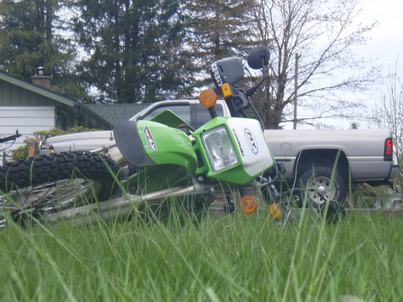

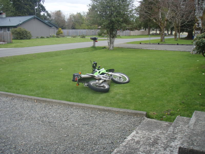

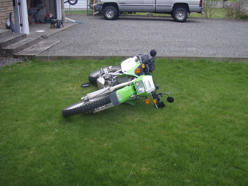

So I went out in the yard to lay the bike over, because I was not going to waste $12.00 worth of oil.
Now keep in mind this is the only time by bike has been like this, well except that wicked hill climb above Lake Crescent on the power lines.

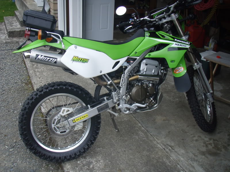

Don't look at how dirty my bike is, and trust me it doesn't look like that now.
Anyway, remember when we all went to do our first oil change? Mine was back in December of 05, and we all agreed that Kawasaki really dropped the ball on the oil filter spring. Well I think that Kawi really screwed up by not putting in a new o-ring with the new filter. Would I pay a dollar more for the o-ring? In a heartbeat.
Anyway, after driving all over town, auto parts store, small engine repair shop and finally the machine shop I got an o-ring although not the right softness. I learned today that o-rings at least the ones we have here in town come in two different types. A 70 and a 90 whatever that means. Ours on the bike is a 70 which means it squishes real easy. I went with a 90 because nobody had the correct one in a 70. Anyway, it was about 5% bigger in diameter and when I tried to push the cover down, it just wouldn't go. I called the bike shop an hour away and asked them if they had the right one, and of course they didn't.
Too bad because my wife was in there doing some major grocery shopping. Anyway the guy at the machine shop told me to tap with a rubber mallet and it should go, and once it did this o-ring would last 10 times longer that the stock one. I did not however have a rubber mallet, so I used the rubber handle on my trusty Stanley Electrician's hammer, and it finally squeezed in there. I fought it for what seemed like an hour, and all I had to do was tap it with a hammer. Well after I got that done, I called the bike shop back up and ordered 3 new o-rings, and a couple of oil filters and oh yes a new clutch cable. I was surprised that the cable was only $14.95. Now I will have a spare.

Are you going to blame the dog for the dead patch where your carby emptied itself? I notice the radiator overflow runs out a bit also on my bike when it is on that side, could just be my routing though.
