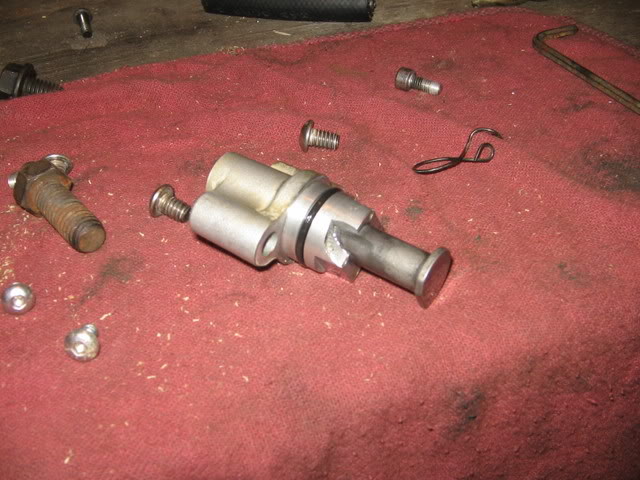

Hey EMS that sounds like the cam chain is slapping does it do it worse when you let off the throttle ??? Sounds like the tensioner is not working at all .... If they did a head and valves on your bike I doult it needed any of that did they show you the bad parts???? Its hard to tell from a video but That sounds like a cam chain.... Wish I was there I would tell you what it is these so called dealer mechanics are idots[:'(]

+1 for the timing chain slap. It could also be that the valve clearances are too wide, but thats really loud to be even that. Almost sounds like a diesel.

Can Eric pull out the adjuster and see whats going on? If you need a new one I have the original one out of my bike that they thought was a problem, I don't see anything wrong with it, and really my bike still makes some noise for about 3 minutes until its warmed up then its ultra quiet. Well except for the Muzzy. I can't believe they let you take it home like that, sounds like metal to metal noise. I would definitely not run it anymore until you get it fixed. Take out the cam chain adjuster and make sure the spring got put back in, that would certainly make that noise if its either not working or the spring was not in there. Let me know.

deej they also replaced the cam chain tensioner.... remember this?
Yea thats part of the problem.... im a nice guy...... but ill call and not be so nice..... try at least. the mechanic saw nothing wrong with how it sounded..... i wanted him to replace the cam chain...but he didnt.
