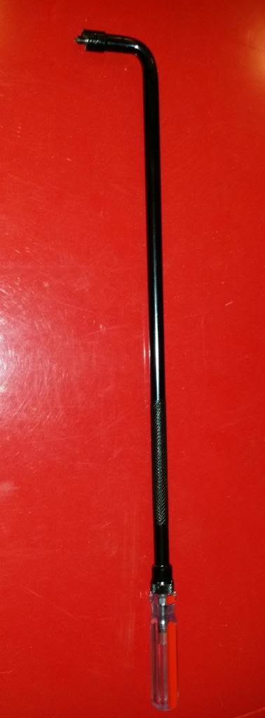

I have one of these, not sure why I even bought it. Never needed it , never used it. Will it work on my carb, will it work on the wife's XT 225?
