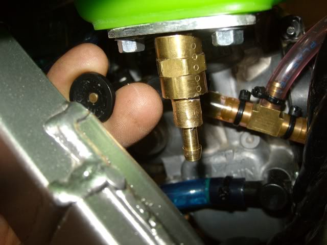

Good shot of the petcock/choke interface. I think I will try shortening the choke rod a little. I fabricated a mounting plate for the pump I picked up today. The tank came in but the post office is closed till monday.

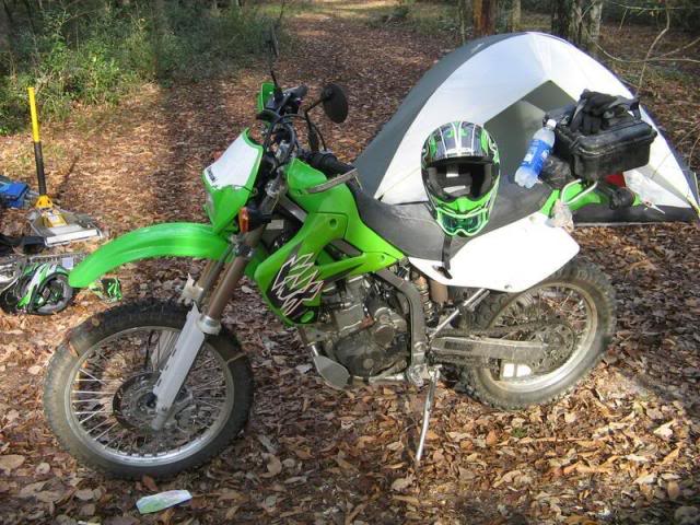

2006 klx250s with klx300 tank and shrouds

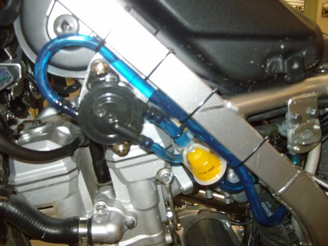

here is the fuel pump set up for getting the fuel out of the wings.
The vacuum actuated pump runs off the vacuum port on the front of the carb (the lower right hand hose). I ran it with the stock tank for a whiel and it wowrks well.

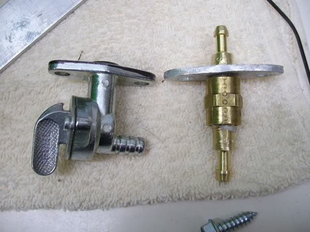

I whipped up a different petcock using a chunk of Aluminium bar and a side gringer with a zip blade

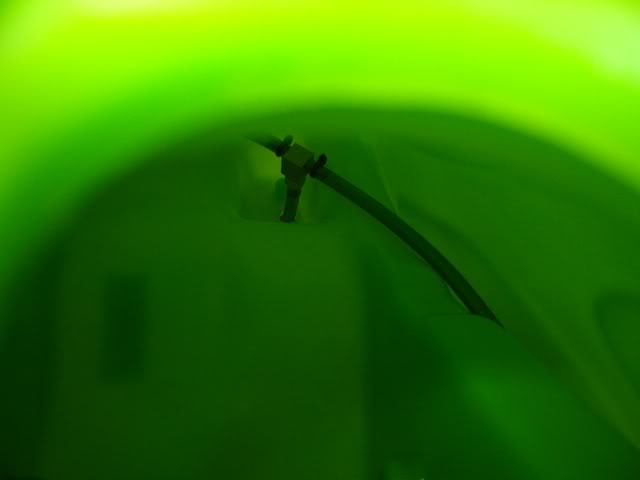

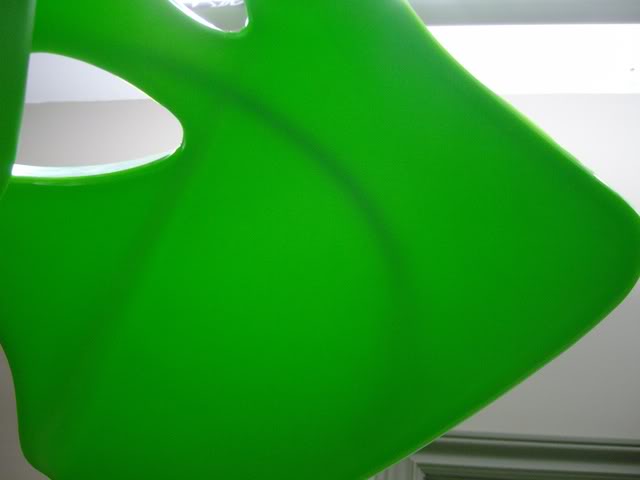

I put together a tee fitting with lengths of gas line and insterted them inside the tank through the petcock hole in the tank. You can see the shadow of one of the lines going into the wing.

Here is a shot of the now clear petcock and choke ****

I will probably use the stock petcock with this setup, and then I will be able to swap out the tanks easily, witht the idea of only using the plastic tank for planned long trips, and the stock tank for comuting to work etc.
