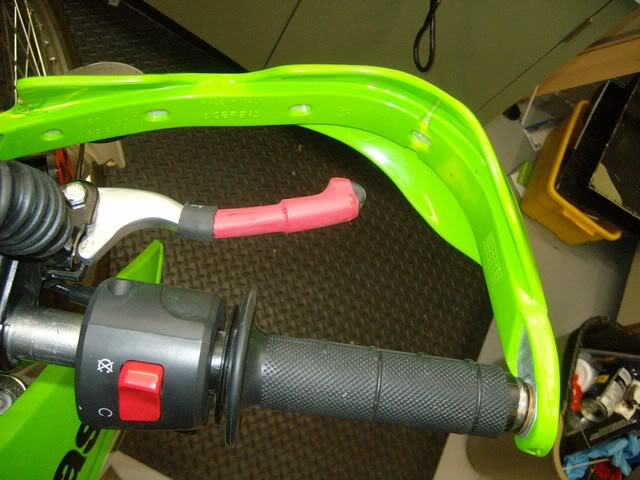

Old Jan 19, 2009 | 11:37 PM
redpillar's Avatar
Posts: 1,389
Do it do it do it
