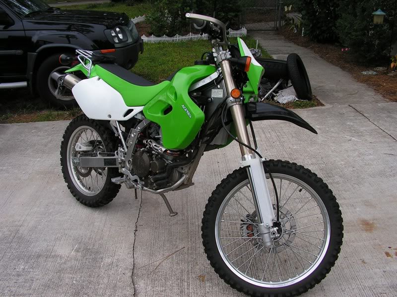

I finally received my Acerbis 3.7 gallon tank. Got here right before I left for a rally up in Tennessee. I had posted a couple of quick pictures, but here is the KLX250S with the Acerbis 3.7 gallon tank installed.

As I mentioned, the install is a piece of cake. Just follow the instructions that Acerbis provides. The Acerbis tank fits better than the stock tank and is easier to put on than the stock one is.

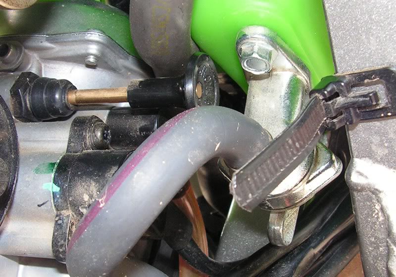

The problem is simply this; with the Acerbis tank installed, there is little to no room to move the choke open. I don't see this as a problem since with the mods in place I really do not use the choke. However, I feel that all stock operations need to function so I will do that before I am satisfied. I want this to be a fully functional modification.
Here is the interference issue and what I'm up against.

I might simply make the choke pull a size smaller. Perhaps a bend in the gas line is appropriate. I don't know at this time, I will look into it and come up with a way to make it 100% complete!

Nice! Does the bike feel top heavy with the additional weight of the gas?

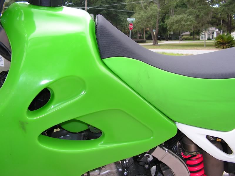

Actually just the opposite is true!
The 'wings' actually hold a lot of the added fuel capacity and that is lower than the stock tank. The first time I took it out, the bike felt like it had been upgraded with "Power Steering"! I am finding out that I have to re-learn to ride the bike as it turns much quicker now than before the tank was installed.

Pardon my ignorance, I am assuming the gas is gravity fed. How does the gas in the lower portion of the tank get to the petcock?

I can't answer that question. Perhaps it is there and if needed you have to tilt the bike to get the full 3.7 gallons.
Once I do a full test, I will let you know how much you can pull from the tank without having to do anything like that. I was going to do just that, but I had a 51 mile ride over a desolate stretch of roadway in the dark with fog - so I wimped out and filled it up with 100 miles on the odometer BEFORE I made the ride. Sorry about that.

I think I'd prefer the Acrebis tank to the IMS from one I've read and seen. For one its green and not that ugly whitesh color that doesn't match anything else on the bike, it looks alot easier to install, and its bigger. But Cactus Jack brought up a good point, how do you get the fuel out of the lower sections of the tank. Maybe you're not supposed to, maybe it was designed to catch any sediment in the fuel, so in a way you could say the Acrebis tank filters the fuel.
